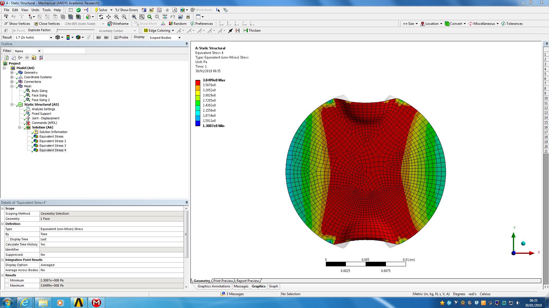

      The displacement needed for yield is 1.6mm (as experimentally tested) however with mesh of 0.00065mm I get a value of 769Mpa and 384MPa (Should be 770MPa and 385MPa respectively) when using ERESX, NO command. When I reduce my mesh smaller, the solution will not converge and states to check solver output or the maximum contact stiffness is to big.
      As I a complete beginner at ANSYS (only been using partially for 3 months) and been stuck with this problem for at least the past 3 weeks, I am running out of solutions to produce yield.

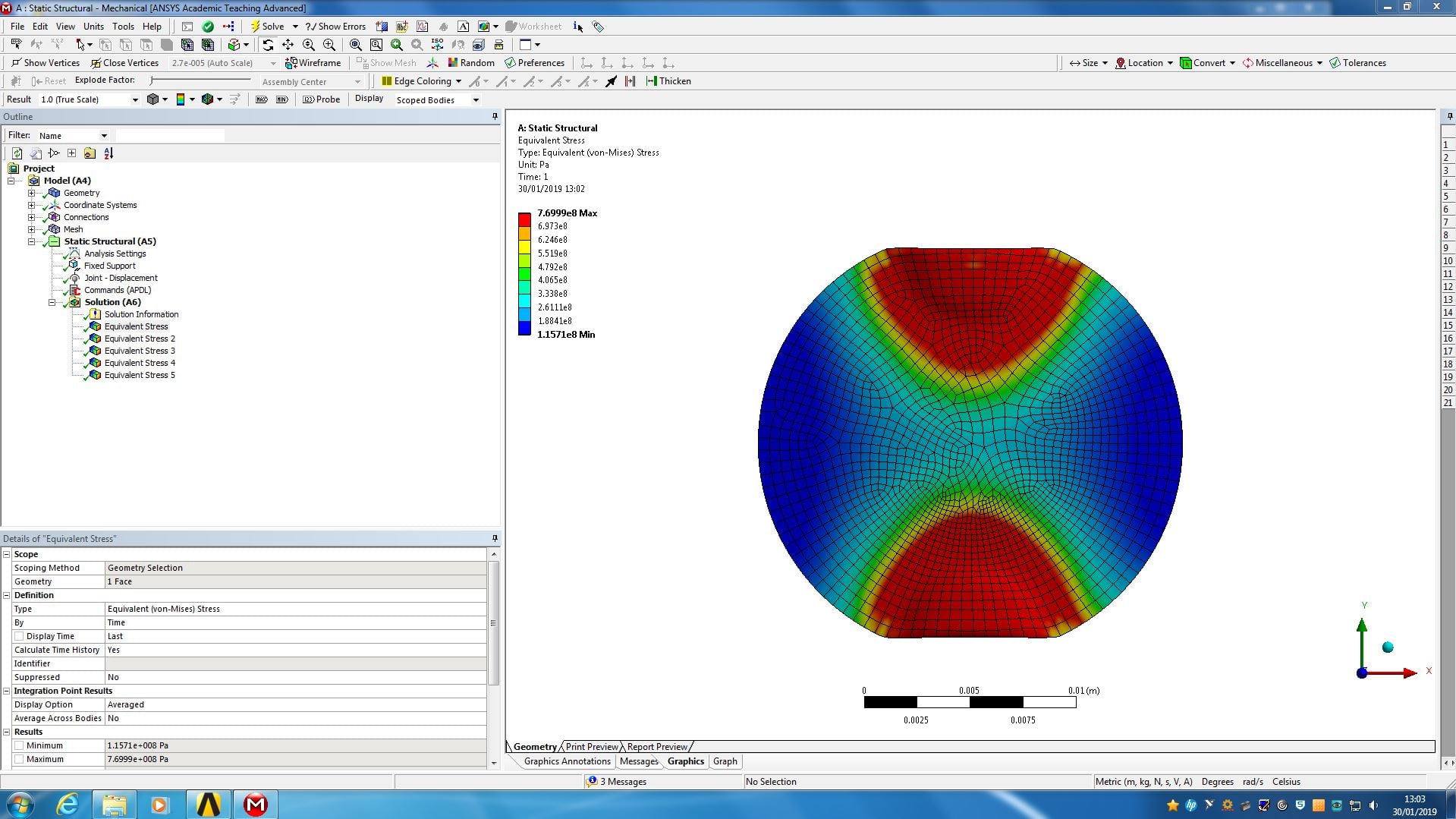

    • liamjstrachan

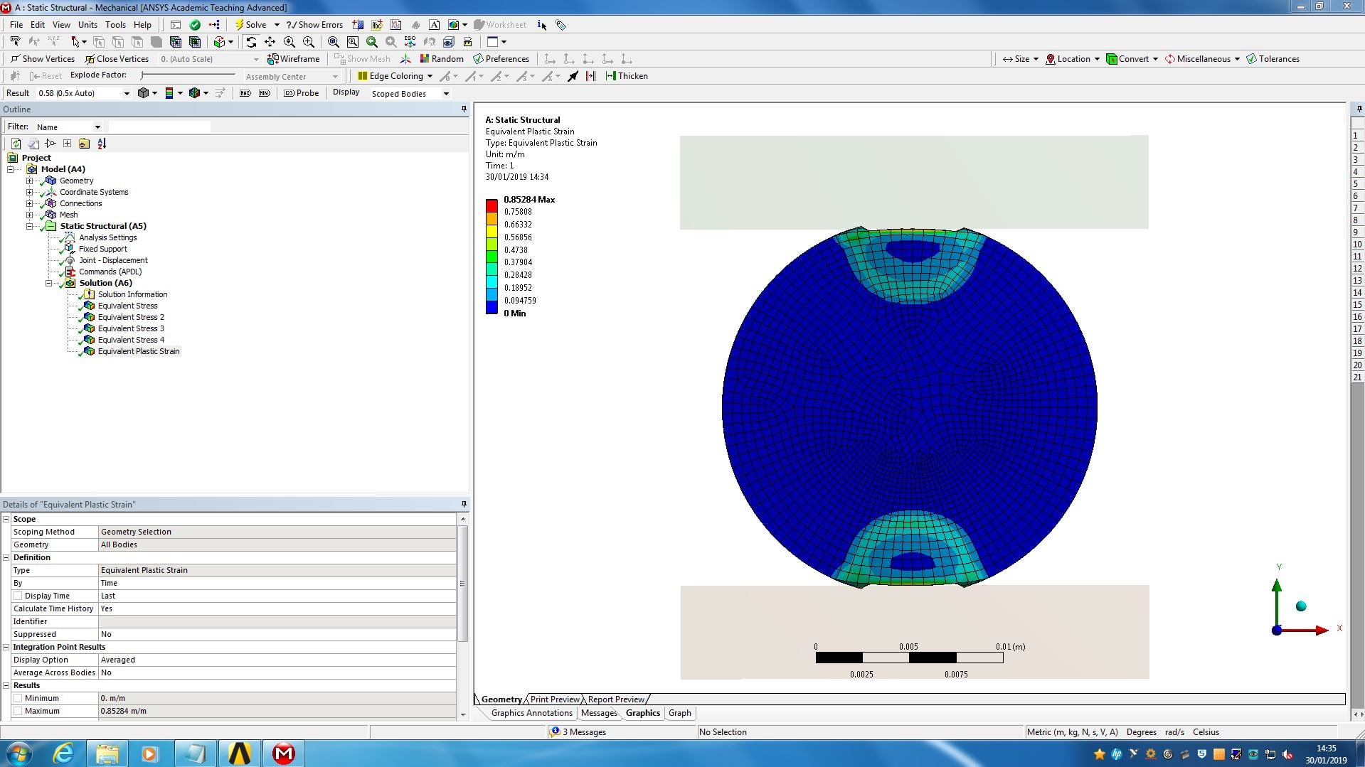

      I left the simulation running overnight and it took around 9 hours to complete. One face shows the yield, however the other 3 do not which I find confusing.
       Ive attached a copy of my model. The displacement of the joint should be 1.6mm, but I increased to 1.7mm to see if it would yield.

      What do you mean one face shows yield, and the other 3 not, you have to be more clear than that in order for us to help you. Do you mean the tool parts upper and lower blocks (with supports). These do not have any nonlinear properties assigned to them so they are purely elastic and will never yield. Also why would you look at the tools to go into yield, normally you look on the specimen.
      As I said to see if it has yielded you need to look on plastic strains! VM stress will not always tell you if it has yielded (as for the two upper lower blocks).
      If we look at the parts shown below they have yield significantly even at a displacement of 4E-4 m. So they have yielded. The other parts as mentioned (blocks), do not show in the plastic strain because they are linearly elastic as explained . In the image you show, the part has failed (large plastic region), since one does not need any more additional force to compress it further.
      Hope this will explain to you what is happening.

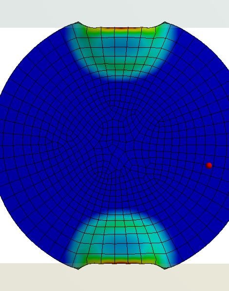

      Apologies, I shall explain the model further.

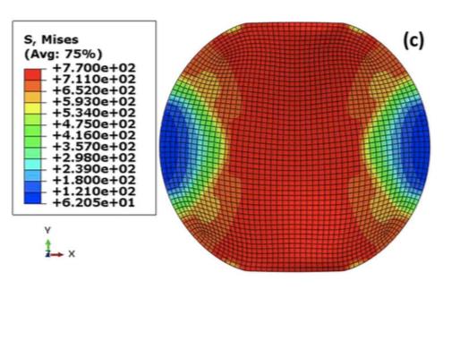

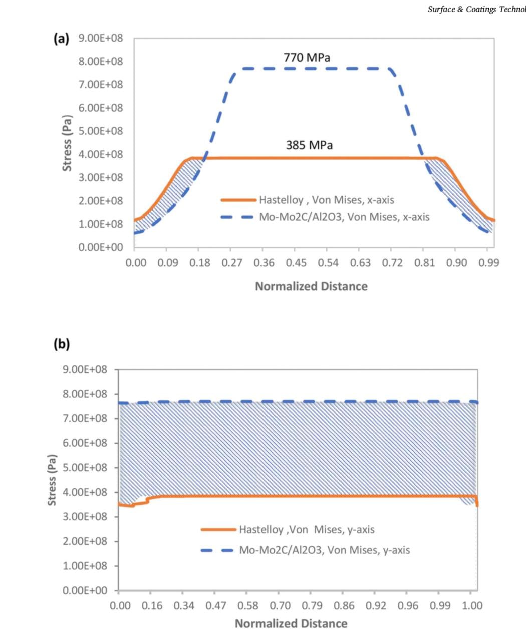

      I am modelling a compression test of a substrate with a coating. When subject to a compression of 1.6mm, both materials should yield (or show failure, like the image I previously attached) as which has been experimentally tested.
      I am measuring the stress at 4 interfaces: coating, coating interface, substrate and substrate interface. Maybe so the model has yielded, however is it possible to show the failure like in the image I attached? Its only as I need to produce a mismatch in stress graph and need to measure the von miss stress at intervals on the x and y axis.
      For example, the one that shows failure I can plot the above graphs, but for image below I cannot as it still shows elastic stresses in the middle of the model.

      Yes, you should be able to plot in ansys these graphs you need and (not sure what they show which distance and which direction).

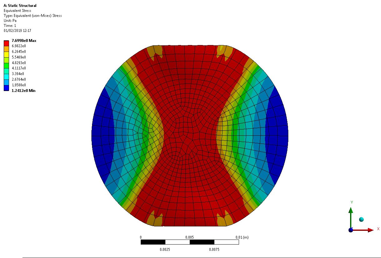

    • liamjstrachan

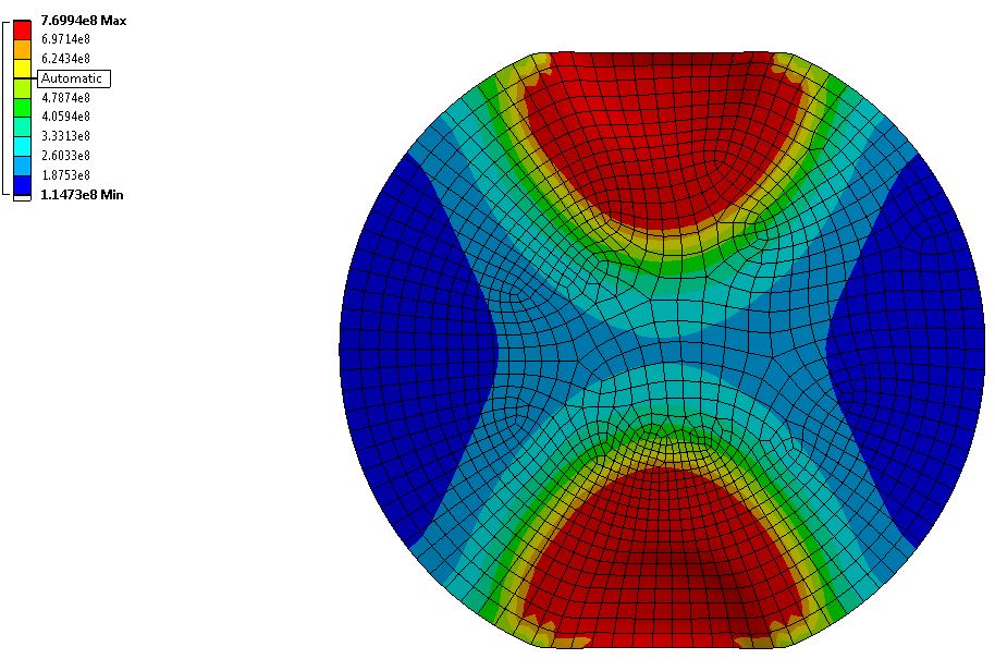

      Yes, on second look my model is yielding since as the equivalent plastic strain is equal to zero which is a result.
      But I am confused as to why one interface is showing failure, but the other 3 are not? as they should all be showing failure with a displacement of 1.6mm, as like I mentioned, has been done experimentally. I even increased to 1.7mm and the results still did not show failure.
      Should I further increase the displacement to try reach failure?
      Pictures below show my results and what I am trying to achieve.

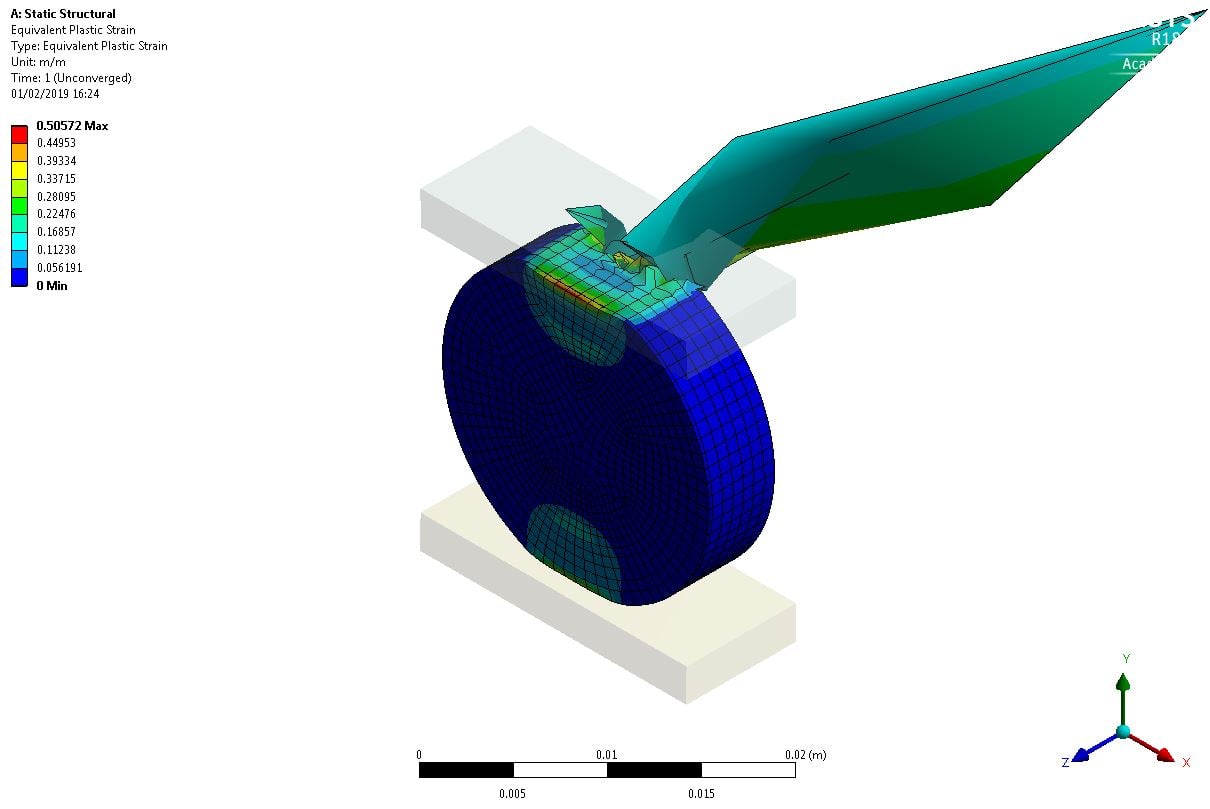

    • jj77
      Could you please show and image of the plastic strain for the whole disc (coat. and alloy) at your last increment (time = 1 s). Thank you.
      Of course to make the whole disc fail you could continue squeezing it further,
      Also do yo have the abaqus input file (I can have a look to see if there is a difference). Or the thesis/paper where you get this abaqus contours from.
    • liamjstrachan
      The paper where I get the abaqus plots from is: https://www.sciencedirect.com/science/article/pii/S0257897218311605

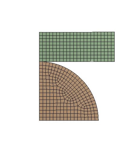

      Also, if I as to just do a quarter model (just to reduce solution time to see failure) what would my supports be on the faces on the disc?
    • jj77
      Ok that has definitely yielded quite a lot (looks like high plastic strains)
      Bottom face would be fix Y, and left faces/sides fix X. Not sure if you see some more local "buckling" at the top, more than in the abaqus model, but I assume you might not have the same deformation scaling (should always be 1 for nonlinear analysis).
      Also the edges of the contact region look a bit strange. Looks like disc is pushing itself into the block a bit.
      Also the width is wrong (should be 10 mm). Find out also what type of steel it is and include yield, and then do a benchmark on the uncoated part and compere FEA (load vs displacement curve) with the load curve shown in fig. 6 in that paper. That should hopefully match, and then you know that you have  a model that predicts the test pretty good. From that you can then add the coating.

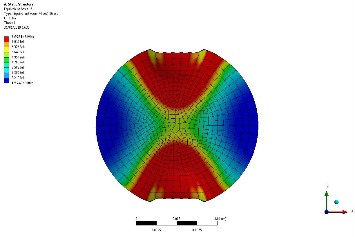

      My model has shown failure for the substrate (385MPa) at 1.7mm displacement, but the coating (770MPa) still wont show failure at a displacement of 2mm. When I increase my mesh size, the substrate no longer fails for some reason.

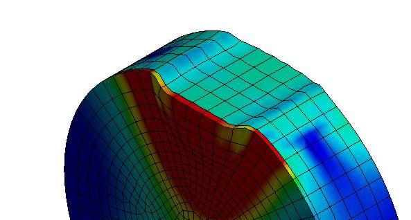

      Also, it looks like the compression is only happening over a small contact area since the two lips are beginning to form at either edge. Could this be a problem? as I thought only local flattening should occur.
      It looks like the disc is not flattening at those areas and actually inserting into the compression platen.

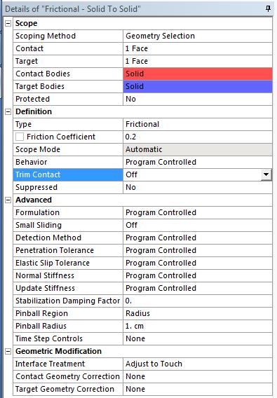

      Liam, the lack of a "flat top" is due to the contact elements not being present to flatten the disk. There are two settings that might help give you the flat top you want.  Make sure Trim Contact is set to Off and type in a large value for Pinball Radius.
    • liamjstrachan
      Thanks Peter, JJ and Sandeep! you have been of great help. Both coating and substrate now show failure after increasing pinball radius and taking trim tolerance off.

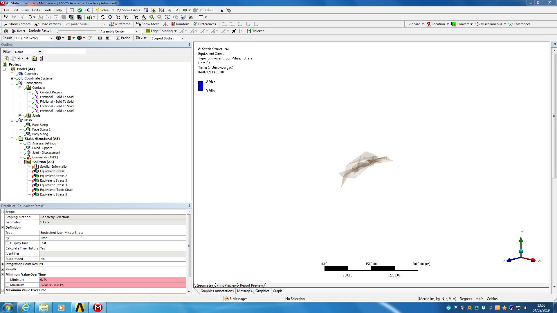

    • liamjstrachan
      Got a problem. When reducing my mesh, the following happens around 3/4 through the simulation and wont converge anymore.
      That might be resolved by adjusting the time steps.
      Do you have Auto Time Step set to On?
      Try using Initial Substeps 100,  Minimum Substeps 100 and Maximum Substeps 200
    • liamjstrachan
      I did. I was using Initial Substeps 100, Minimum Substeps 1 and Maximum Substeps 200.
      I increased the the minimum to 100 and re-ran the simulation and got the following results:
      This problem only seems to occur when reducing the element size.
