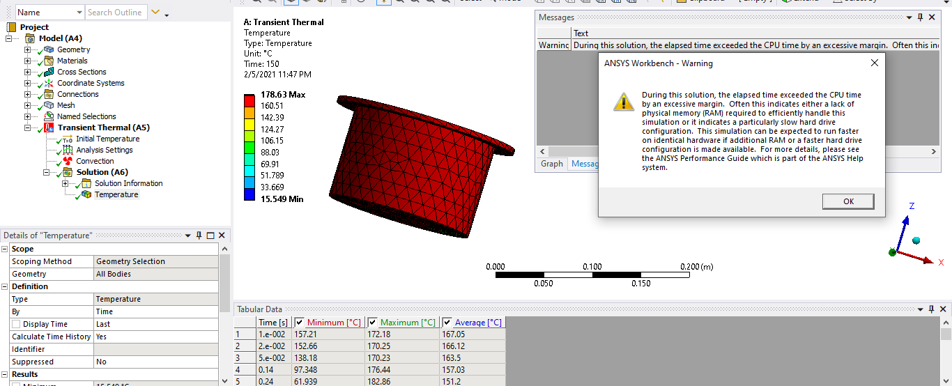

Subscriber.Hi, I am getting an error of "elapsed time exceeded the CPU time by an excessive margin" when running ANSYS on a core i7, 8th Generation HP Probook 430 G5 laptop with the following properties: Processor - Intel(R) Core(TM) i7-8550U CPU @1.80GHz 1.99GHz; Installed RAM - 32 GB ( I upgraded it from 8GB); System type - 64 bit OS, x64 bases processor.
What could the problem? Kindly advise since the results are not as expected.
Thank you in advance.

Forum ModeratorI suspect the two parts to your question aren't linked. The cpu warning implies you may be paging to disc so check RAM usage during the calculation.
Re the results, check mesh resolution and boundary conditions. The Mechanical experts will be able to assist more if you provide more details of the set up.

Paging to disc is when the hardware runs out of RAM and starts dumping the overflow to the disc. Discs are slow compared to RAM so the whole solution slows down. With the old rotating disc drives you could hear it, and occasionally smell it as the bearings gave out.
February 19, 2021 at 10:20 pm
peteroznewman
SubscriberArray
It's a Warning message not an Error message. The system solved, it just took longer than it could have.
Are you storing your model on a network drive and not the local C: drive? Don't ever do that. Access time to a network drive is very slow.
If the file is stored on the local disk and that is a spinning hard disk, you can get better performance by installing a Solid State Drive (SSD).
You can add that as a second drive letter D: or you can rebuild the computer and replace the C: drive with a SSD.
The model file looks relatively small, so I doubt you ran out of RAM.

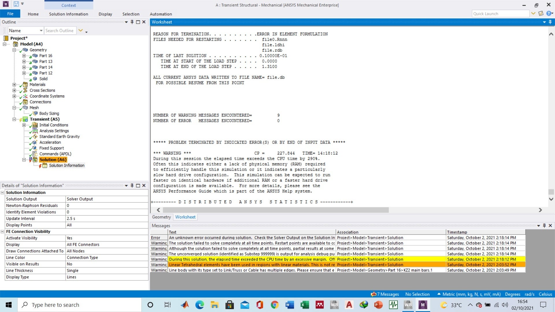

The warning that the elapsed time exceeded the CPU time is independent of the error.
The error that stopped the simulation has to do with either a nonlinear material model or just element distortion. Look higher up in the solution output for more information. One mitigation to try for this error is to turn on Auto Time Stepping and set the number of Initial and Minimum Substeps to 100 and Maximum Substeps to 1000.
