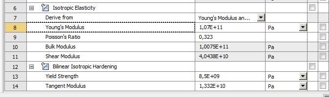

SubscriberI suggest you use a Plasticity material model to prevent elements from carrying more stress than some limiting value. This is much simpler than using EKILL. The simplest plasticity material model is Bilinear Isotropic Hardening. Only two inputs are required: Yield Strength and Tangent Modulus. If you set the Tangent Modulus to 0, then the element will never carry more stress than the Yield Strength.
When you use Plasticity, you have to turn on some things under Analysis Settings. Turn on Auto Time Stepping and set the Initial and Minimum Substeps to 100, and the Maximum Substeps to 1000. Turn on Large Deflection.

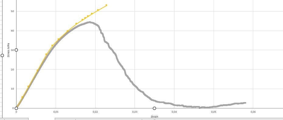

The laboratory test measured compression force and displacement as the raw data from the sensors. That is what you should try to reproduce. Get that raw data if you can. Typically, the Force is converted to Engineering Stress by dividing by the Initial cross-sectional area. The displacement is converted to Engineering Strain by dividing by the Initial Gauge Length.

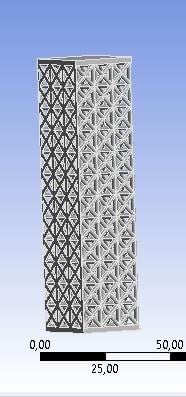

For a Plasticity material model, the Engineering Stress and Engineering Strain have to be converted to True Stress and True Strain. Did you do that? Are you using a Plasticity model, which one? When Ansys solves a model, the output is True Stress and True Strain. What have you done to plot the yellow curve?
What is this material? How is it possible that the force could drop to zero? Do you have images of the test setup and the sample shape before, during and after the test?

Thankyou for the reply, the yellow curve was traced, for the stress obtaining the reaction force at the base of the specimen divided by the area and the deformation as a change in length divided by the initial length

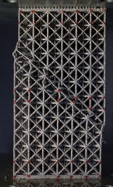

SubscriberPlease reply with photos of the sample after the compression test.

peteroznewman
SubscriberYou can see that beams in the structure failed along a max shear plane and the structure lost all stiffness.
You could simulate that if you create a geometry that has a small flaw in the geometry that will seed this mode of failure.
If you have perfect geometry, that mode will not be initiated and you will just get uniform compression.
