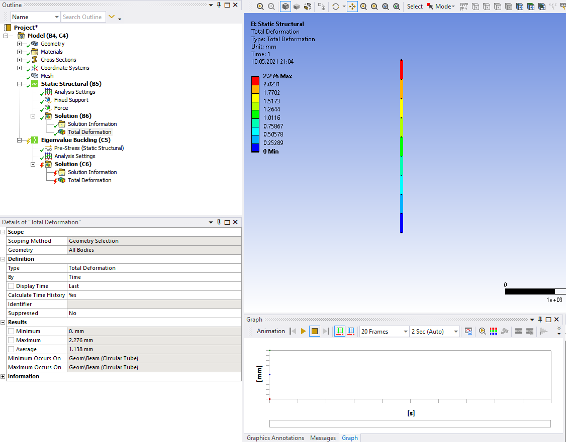

SubscriberHello everyone, I have already asked this question before and returned to it again since I did not receive an answer. The simplest model with one post and vertical load has been created.
May 10, 2021 at 5:31 pmpeteroznewman
SubscriberPlease show that the static structural model with the load has been solved.

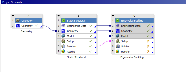

May 10, 2021 at 6:05 pmMay 10, 2021 at 7:45 pmpeteroznewman
SubscriberPlease show an image of the Workbench. Do you have a link from the Solution cell of the Static Structural to the Setup cell of the Buckling system?

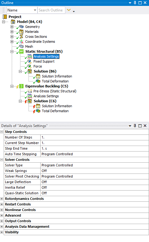

May 10, 2021 at 7:48 pmMay 11, 2021 at 1:20 ampeteroznewman
SubscriberThe Static Structural model must be Linear. That means use only Linear materials, no plasticity, no hyperelastic materials. Do not turn on Large Deflection under Analysis settings. What version of ANSYS are you using?

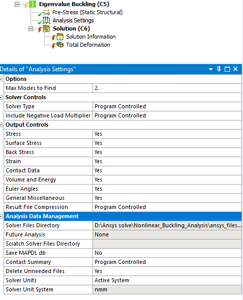

Before doing that though can you try making a new example/project, and the save it in a folder say under your user account so e.g., C:\Users\evgenii., and see if that works.
Finally if that does not do it, in the static analysis use/insert an apdl command object:
rescontrol,linear,last! Turn on restart files due to future eigen analysis intent
Let us know how it goes
May 12, 2021 at 7:22 pmEvgenii_K
SubscriberThanks for the answer ekostson and peteroznewman!
I did everything as written, took the peteroznewman model - put it in C: \ Users \ ... \ ... and recalculated, but the result is still negative, I also inserted the rescontrol, linear, last command into the structural analysis. I think the problem is with the license - you need to figure it out.
