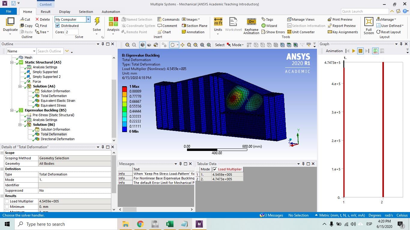

Hello, I'm trying to run an Eigenvalue buckling analysys in Ansys to obtain the first mode deformed shape for the tapered girder shown in the image. I'm getting a very close critical buckling value to the one reported in the bibliograpgy I'm studying but the total deformation seems to have a max value of 1mm, which makes no sense and i think is the reasons of some errors in a further non linear analysis. Do you know why I'm getting this result?

Buckling mode shapes do not represent actual displacements but help you to visualize how a part or an assembly deforms when buckling.
Please refer to this documentation for more details: https://ansyshelp.ansys.com/account/secured?returnurl=/Views/Secured/corp/v195/wb_sim/ds_buckling_analysis_type.html?q=eigenvalue%20buckling
