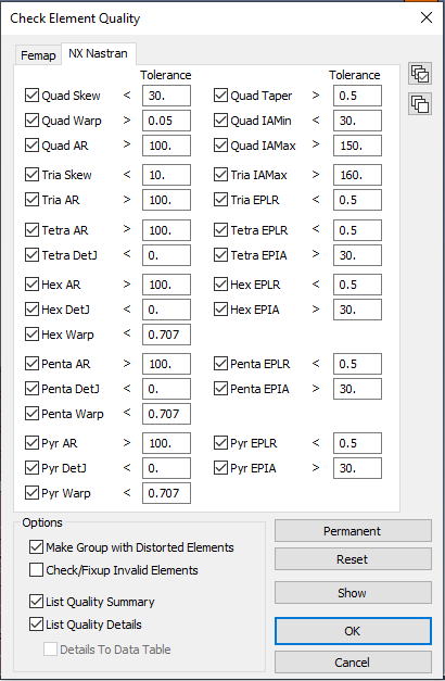

      What I like about Siemens Femap pre-processing software, the Element Quality limits are automatically presented to check which elements violate the limits, and put in a group for easy identification.
      Meshing in Femap is different than meshing in Ansys Mechanical. Femap will create a mesh with elements that fail the element quality check. You can then go in and fix individual elements, such as splitting a failed quad element into two triangles. Ansys Mechanical will not give you a mesh. You have to go back to geometry, and slice it up to get pieces of geometry that it can mesh without creating any failed elements.
