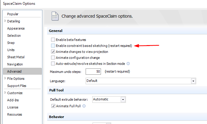

      Hello Tony Dean Ok, I now get your point. If you notice, the latest version of SpaceClaim has a separate tab for sketching. When you create any sketch using the tools located within this tab, you need to create a dimension and then you can edit the sketch dimensions. This type of sketching is referred to as constraint based sketching where you can specify dimensions as well as add constraints to your sketch. The other option which is shown in the sketching video is to create direct sketch without any constraints. For this, you need to disable the Sketch tab. Go to File Menu and click SpaceClaim Options. Then under Advance section, disable constraint based sketching option. See below snapshot. Now restart SpaceClaim. The Sketch tab is not visible but the sketching tools are located in the Design tab. If you create a circle sketch and then select it, you will see it's diameter value which can be edited.
    • tony.dean
      Understood! Thank you so much for the explanation.
