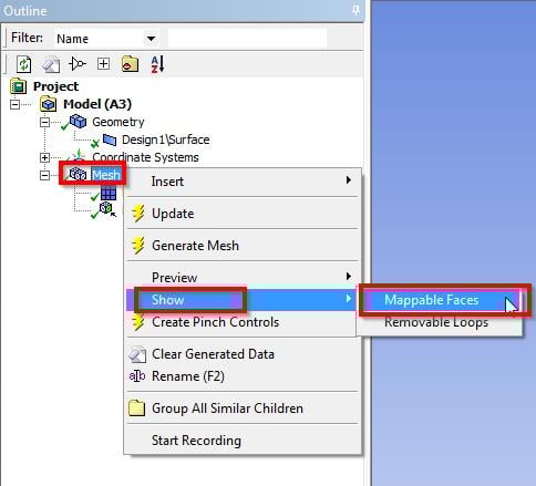

SubscriberYou've got to use "Face Meshing" to get the mesh you're looking for. Once you apply the "Face Meshing" you can set your sizing to that edge and the mesh will be as you want it. Refer the link and image attached below:
Mapped Face Meshing in ANSYS Workbench

SubscriberYou can separate the geometry into two parts at the location (shown below in the image) and "Form a New Part" in design modeler. Then open your meshing and continue the Face Meshing + Edge Sizing.
Refer to following youtube tutorials for meshing on a very similar geometry:
Mapped Face Meshing (7min33s to 10min07s)
ANSYS Workbench - Improve Meshing in 3 Easy Steps
