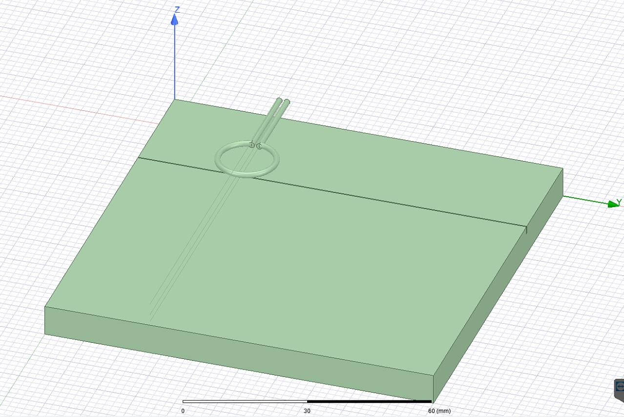

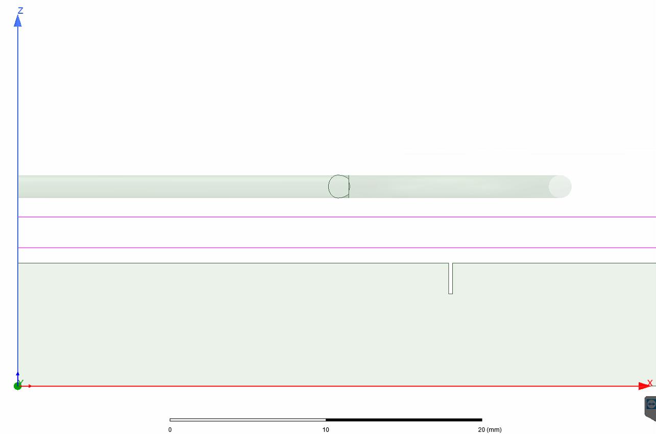

      I am trying to simulate a magnetic field generated from a coil with a current of 150 mA (solid) with different frequencies to detect defects in metal. I have simulated tree defects of 0.5, 1, and 2 mm of deep. In theory for higher frequencies should be well detected defect smaller, like 0.5 mm, and for lower frequencies should be easy to detect deeper defect, like 2 mm, but when I simulate it is it the opposite. I chose maxwell - solution type - eddy current. How could be?
      This is the coil on the top of the sample:
       coil on the sample
      This is the lateral view:
      laterale
      The field at 1 mm from the sample with a defect of 2 mm at 1 kHz:
      The field at 1 mm from the sample with a defect of 2 mm at 20 kHz:

      Where did you find such theory.
      The theory says that the penetration depth decreases, which can help filtering out large defects. It does guaranty you detection of smaller ones. Unless there is very high loss.
      you see, higher frequency excitation tend to be converted to traveling waves, or at least leak along the wide surface. sot this is a pure phenomenology and art of searching for ghosts. it helps when the sweeping resolution is high and excitation current is very stable.
