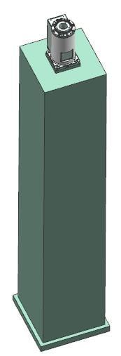

      I need help with calculation of stand under scara robot. I think it should be a rigid dynamics but i´m not sure.Image is in attachment
      I don't see any file attached. You should also expand on the description of what results you want to get from your model of the robot simulation. Is it the deformations of the stand due to loads on the robot arm?  That would not be Rigid Dynamics.  Is it the forces and torques on the joints in the stand as the robot lifts a load? That would be Rigid Dynamics.
    • minko
      Now you should see that file. I want to design stand so I need deformations and stress of that. Defomations and strees is due becouse of robot moving. Robot carry load aproximately 1 kilogram and move very fast.
      Okay, I see your stand. What are the dimensions of the top and bottom plate?  What is the plate thickness?  What is the size of the hole in the plates? What is the dimension from the edge of the plate to the center of the hole? What is the tube diameter? What is the tube wall thickness? With all those numbers, you can easily draw the stand in SpaceClaim.
      You also have to know the material, I assume it is steel, but what is the yield strength of the steel?
      You also have to know the loads that the robot arm creates.  There will be some force at some distance from the axis of the tube. You have to supply the magnitude and direction of the force and the distance from the axis and the top of the stand.
      If you want to include the dynamic load, you will need the mass properties (mass and moments of inertia) of the entire robot arm including the 1 kg payload, and the acceleration of each joint.
    • minko
      It will be made from steel with tensile yeld strenght 200 MPa. Shape of stand is not importand I want to do topology optimalization of weight of stand

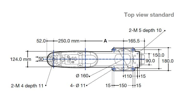

      The robot has armA and armB and joint1and joint2.  You need the mass properties of each arm individually as well as the mass of the base, and the peak angular acceleration of each joint in order to estimate the dynamic load on the stand.
    • minko
       Weight of all robot is 29 kg. Weight of each arm i can´t find yet. Moment of inertia can´t help us?

      Bolts on the fixed portion of the plate to the floor will be M20 and dimensions of plate will be 350 x 350 x 30 mm. And bolts to the base of the robot arm will be M10 and dimensions of plate will be 200 x 200 x 25 mm .Base of robot from the floor will be 950 mm height.

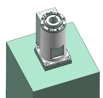

      Now it works thank you. I see that you made remote point 2 and you don´t use it? What with mass point, shoud I give it there?
      I have in windows Slovak language I am from Slovakia in Europe.
      The first remote point is where the forces and torques are applied.
      Remote point 2 is where the point mass is located, but attached to the same bolt holes.

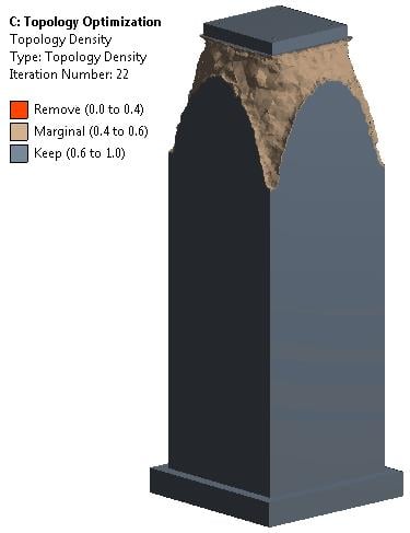

      I will add those improvements to the next archive. Here is what the archive I attached above (6 steps, no vertical) does after 370 iterations on my 8 core computer.  It hasn't converged, it's still calculating, but it looks like the mesh is a bit too coarse to give a nice surface. When more elements are used, the solve time will increase, so it will be even more valuable to reduce the solve time with KUSE and Direct.
      I found an answer about whether all 8 load steps will be used, look at the line objective 2. The answer is only load step 1.

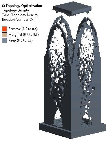

      I have figured out how to get all 6 load steps into the optimizer (vertical loads combined with moments).
      I ran that model, and it converged. If I turn down the retained mass to 12%, the need for a minimum manufacturing constraint on member size is apparent. That will be added to the next run.
      It was using all six load steps.
