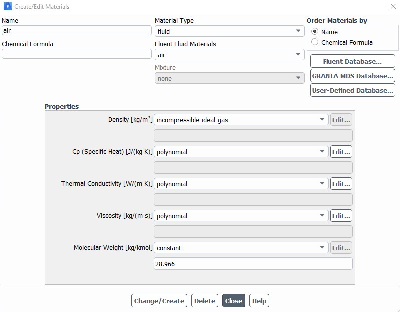

I am simulating the airflow in a tube with varying temperature. The inlet temperature is set as 450 C. The outlet temperature is around 200 C after initial simulation. The material is user-defined air.
May 25, 2021 at 1:03 pmKarthik Remella
AdministratorHi Wall y+ indicates generally indicates the whether or not you are modeling the laminar sub-layer. Since you are modeling a heat transfer problem, I'm guessing you might want your y+ values closer to 1 (for better accuracy). To achieve this, you might need to further reduce your 1st layer thickness when you generate the computational mesh.
Again, this also depends on the near-wall treatment you are using (under Viscous models).
Since you have the two temperatures, estimate the y value based on the two viscosities and pick the lower value and try.
Karthik
May 25, 2021 at 1:23 pmDanielgkh
thank you very much for your explanation. I am using realizable k-e model with enhanced wall treatment. Does this statement "y+ values closer to 1" applies to this model as well?
Thanks again in advance.
June 7, 2021 at 11:49 amKarthik Remella
AdministratorHello The results from the Enhanced wall treatment depends on your mesh resolution. If the mesh near the wall is refined enough, it can capture the viscous sub-layer. If it isn't, it behaves similar to a wall function model. It all depends on the mesh. To answer your question, yes - it does have the capability to resolve the sub-layer details (y+ ~1).
