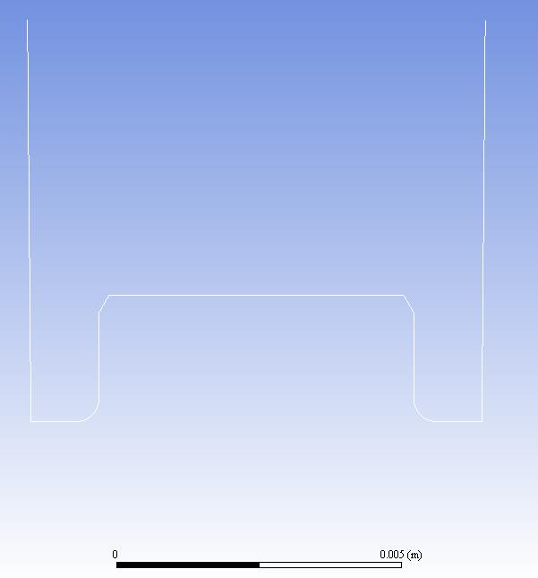

      I´m trying to simulate the movement of the piston in white. Triangle elements for the mesh (size 1e-4m). UDF function for the velocity (v=0.075*cos(30*time)) and an amplitude of 5mm for the movement.
      Below the setup for the dynamic mesh (Piston as Rigid Body - Interior as Deforming and Wall_Piston as Stationary).
      When I display the mesh motion, I have not straight lines which move with the piston, and when I remove "Wall_Piston as Stationary", it disappears.

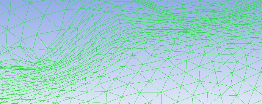

      Thank you for your answer. Yes, it´s a 2D-Simulation. I changed the wall piston as Deforming and used Cylinder as Definition (see below).
      When I display the Zone Motion, I can see the wall piston and it moves in straight line with the piston.
      Problem is that I add the following error message:
      Maxime
      As it's a warning the mesh preview should still work: what does the mesh look like? Which bit is actually moving as it could be the chamfer angle is giving some remeshing issues.

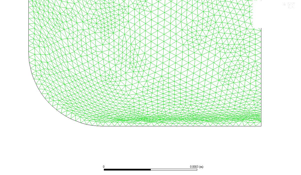

      I have set the Wall_Piston as Deforming and faceted. I have made a finer mesh (element size 3E-5m) with a delta t of 1E-3 s.
      This picture shows bad cells with a high skewness at the bottom. Is there any way to avoid this or to remesh earlier ? I set the remeshing intervall at 1. For exemple, decrease the time step size.
      There I have the same problem with bad cells. Should I create a Cell_Zone which is attached to the piston and which moves with it?
      Maxime
    • Keyur Kanade
      in smothing plesae use sprint constant = 0 and nf iterations = 100
      in remeshing please mesh sure you put the values for min length scale as given in mesh info. max skewness can be 0.7.

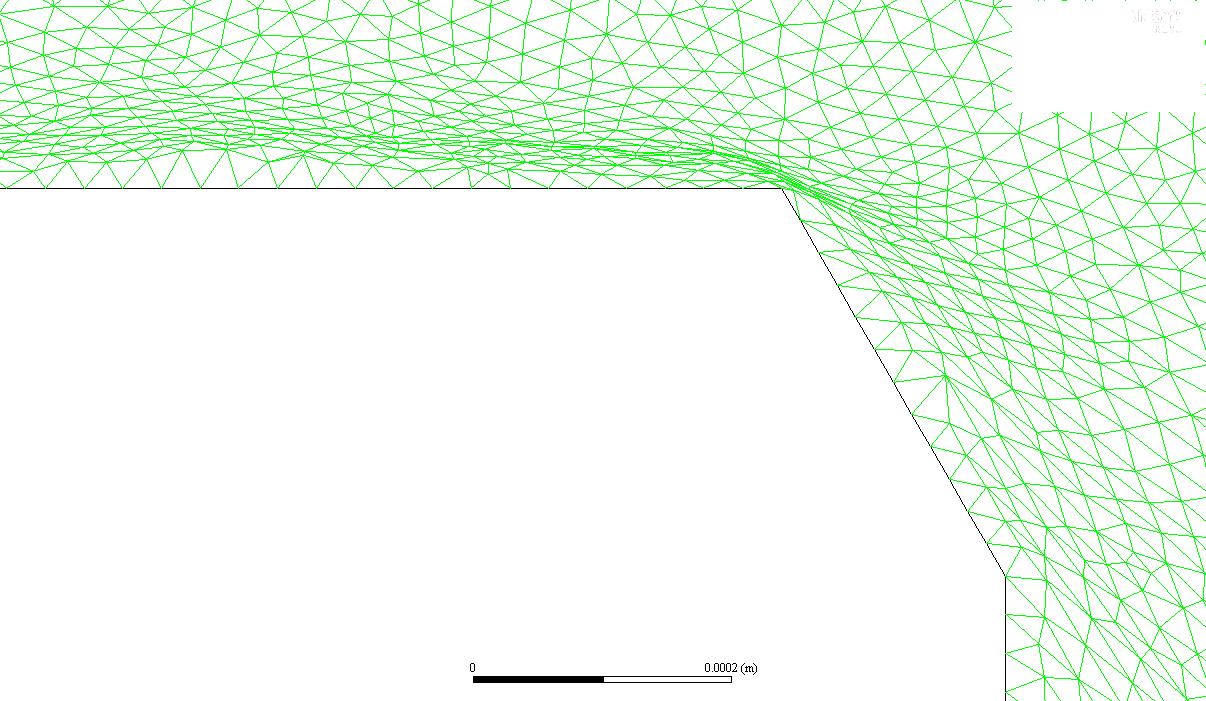

      Thank you for your answer. I change the spring constant as 0 and the others parameters had I already.
      I have taken a time step size of 1E-4s with 100 iterations and a remshing interval of 1. Around the piston it looks good.
      But there is another problem. First at the corner in red circled:

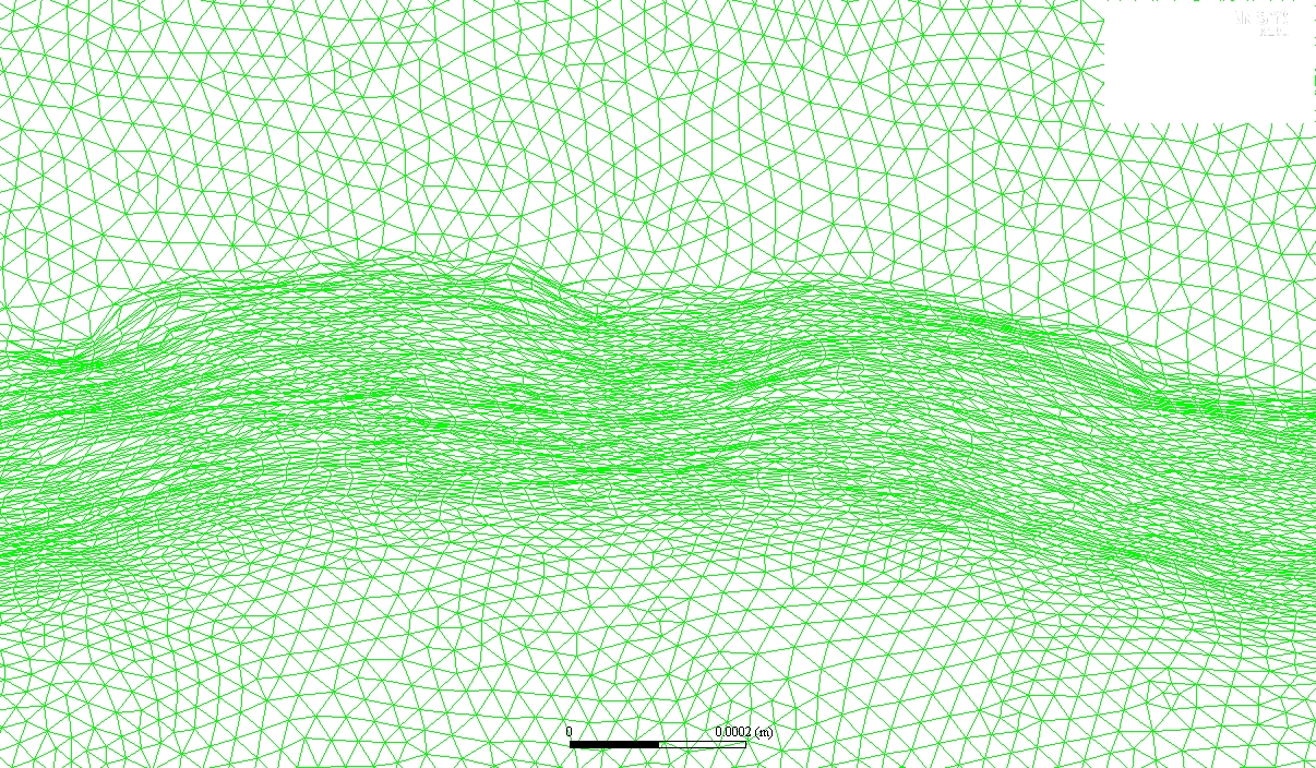

      Then, in the domain on the top of the piston, the cells are compressed with a high skewness (0.95 - 0.98).
      When I ticked "Local Cell", Zone Remesing is enabled by default and will be triggered if local cell fails to create an acceptable mesh. Howewer, it will be invoked if skewness > 0.98, and can be lowered to 0.96 by using rpsetvar 'dynamesh/remesh/max-thread-skew 0.96. May it changes something ?
      Should I add the Layering?
      Maxime
      Try running the mesh preview with a smaller time step, ie a factor of 10 lower and see what happens.
