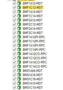

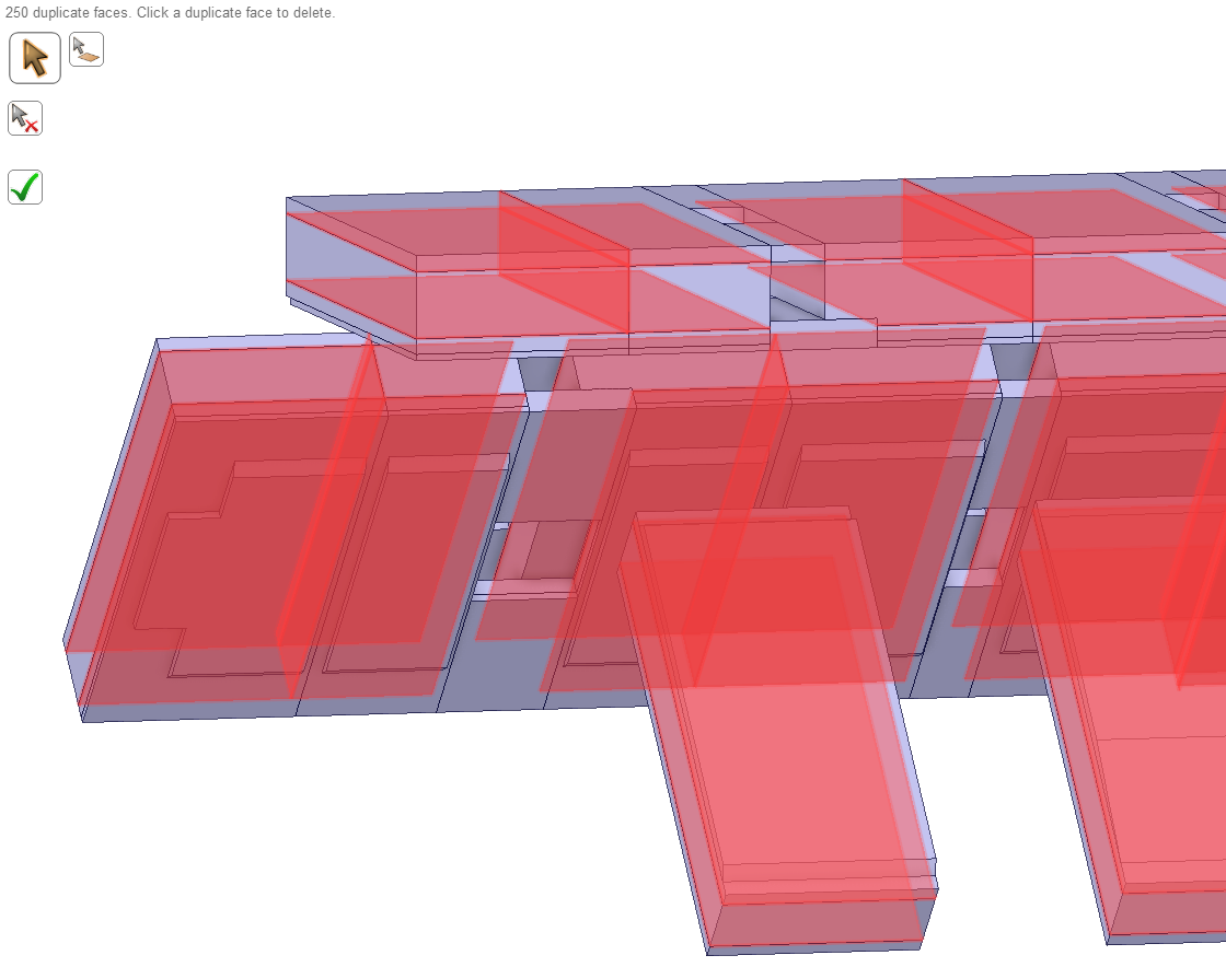

I'm trying to prepare a geometry for Fluent simulation and when I try to subtract solid bodies from the air volume it throws an error (not all bodies are cut out, just some).ÂÂWhen I checked the solids to be subtract I noticed that the Spaceclaim shows duplicate facets at the solid contacts, but the "Repair/Duplicates" command is not able to delete these facets. How can I get rid of these duplicate facets without completely remodeling? (it is not possible to re-model, as I need the original complicated names, which would be a nightmare to re-write manually for nearly 100 bodies)
I've also tried using the "Pull" command to move the contacting faces away from each other, then using the "Up to" command to "touch" them again, but the same duplicate faces are displayed by Spaceclaim. It seems like if there is a problem with the tolerance of the surfaces, but when I create my own models I have never had such a problem. As far as I know the original CAD model is based on a .step file anyway.

The problem is that it does not subtract solid bodies from the fluid volume for which the "check geometry" command does not show any errors. I believe this is due to the duplicate surfaces I attached a picture of in my original post. If these were fixed then the problem would be solved and Spaceclaim could subtract the body from the fluid volume.Â

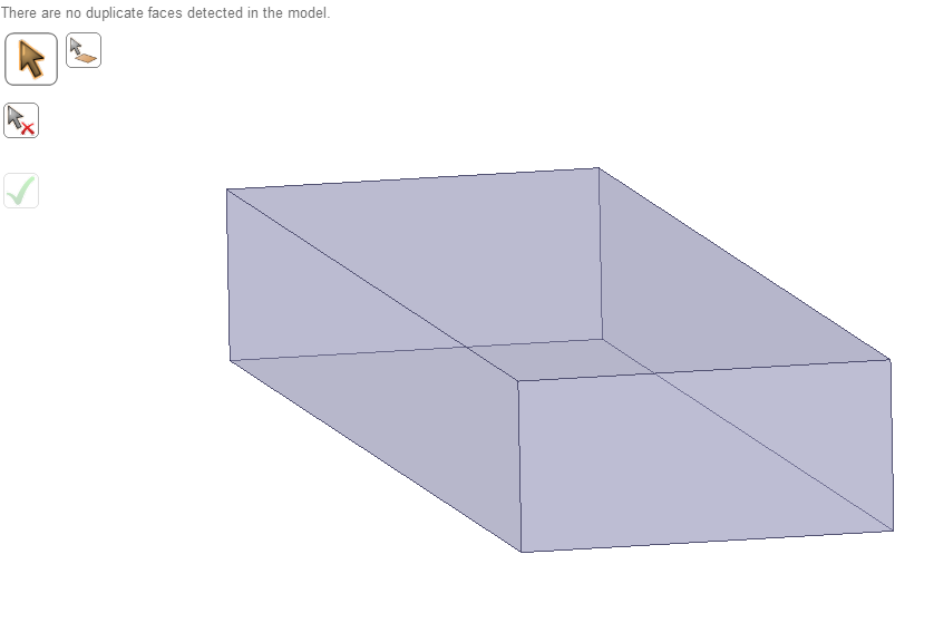

Are these duplicate faces in the same body? If it is a solid body then how it can have duplicate faces? Can you please check duplicate faces for a single body and insert image here? The image you have posted does not give any information about how many bodies are visible. Please insert more images with more explanation.Â

If I want to subtract one from the other, I get an error, so the bodies are clearly not intersecting, and if I check just one solid body it shows no duplicate faces.Â

Ansys EmployeeFrom images and description it looks like you have some solid bodies and some surface bodies.Â
Duplicate tool works only on visible bodies. Make sure you have only one solid body visible. Then try Duplicate. Does it show any duplicates?Â
Now make only 2 surface bodies visible which are coinciding. Now use duplicate. Does it show duplicate? If yes, delete one duplicate surface body.Â
You may also want to check Share Topology option.Â
Also see Split Body option.Â
Please go through help manual for more detailsÂ

Ansys EmployeeInsert an image of only one solid body. Make it transperant. How can a cuboid solid body can have surface inside it?Â
July 28, 2023 at 1:32 pm
levente.bicskei
SubscriberThere is no surface inside the bodies. Two transparent solid bodies:Â
Only one:Â
Clearly the problem is that somehow the surface in contact is not only in contact, but also coincident. The question is how can I solve this problem without remodelling the bodies? Because at the end I'm going to need that hundreds of specific names of these solid bodies what you can see on the attached picture on my previous reply. -
