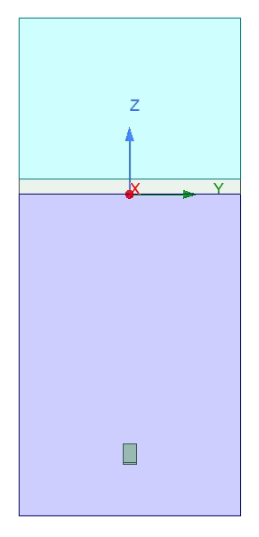

      Hi Ansys Learning Community,
      I am trying to simulate an air water boundary using Plane Waves as a source. What would be the correct boundary settings to simulate this properly?
      I've used floquet ports and the results match Snell's law however, eventually I want to insert objects at the water/air boundary to see the impact. Can I still use floquet ports in this scenario?
      I've set the Global Material Environment to Water or Air and the results dont make much sense. I should see the plane wave refract towards the angle calulcated by Snell's Law.
      I used PML boundaries around the water region, and Radiation Boundaries around the air region since the global variable is set to air. The image below is using a waveguide probe instead of a plane wave. I was thinking that would be more accurate, but the results are still strange.
      Waveguide Probe in Water
      Any pointers or suggestions would be much appreciated.
      Thanks

      Thanks for your reply. Using the floquet/lattice setup I am able to simulate unit cells with no problem. However, it doesnt seem to work when I try and simulate a larger structure like a Frequency Selective Surface for example. I think the problem I am facing is that the global material variable doesnt allow me to inject a plane wave from a floquet port assuming 1 material and then measure the far fields assuming another material.
      For example in the image above, if I set the global variable to water the plane wave enters the bottom water box as expected. It then refracts (I am assuming) correctly into the air box , but then once it leaves the air box into the "infinite" environment, the far fields are calculated using the global variable as water where I want it to be air.
      Is there a way to adjust this?

      Thanks for the reply. The issue with setting the Global material as air is that the floquet port plane wave will not enter the water as expected due to snells law. For example if I want the water plane wave to arrive at 40 degrees, it will refract from the beginning and appear to enter at 4 or 5 degrees. If I set the global material to water however, the plane wave arrives correctly but then I cant view the far fields assuming an air medium.
