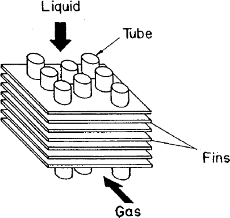

      I am trying to analyze a heat exchanger(as in image) that have too much fins. One of the sides is air and the other is water. Because of the complexity of geometry, i decided to analyze with dual cell model. I took a tiny slice from heat exchanger geometry and analyzed parametrically (the parameter was mass flow rate). Then to use dual cell model, i simplified complex geometry taking an example from second image, i removed fins from air side and removed tubes from water side on the geometry. I defined porous zone both air and water sides, I took massflow-dependent heat transfer results and transfer to heat transfer data tab(raw-data tab). Then i analyzed the simplified geometry. But i encountered the prompt that says:

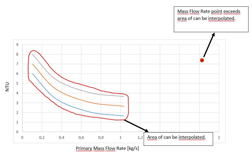

        Thanks for the answer. Now i understand the reason of error, ı guess. I simulated a slice of exchanger geometry and because of that i defined very small mass flow rate at the inlet compared to full exchanger geometry's mass flow rate. I know that Fluent scales the NTU value depending on mass flow rate. When i transfer flow-dependent heat transfer data from case of slice geometry to case of full geometry, mass flow rate data might be  too small to interpolate. I guess Mass Flow Rate point of full heat exchanger exceeds area of can be interpolated.
        Is my detection wrong?
        Is the method that i following to perform the dual cell model right?
        If it's not, how should be the method?
