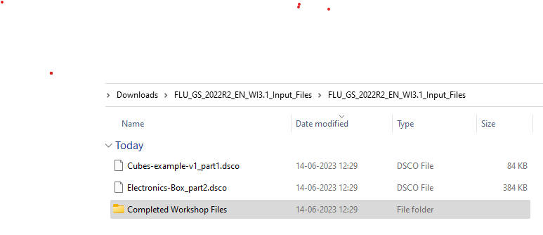

Subscribersir, i am currently watching ansys fluent tutorial videos and file hence downloaded has .dsco file extension, this extension is not shown by ansys cad geometry in import geometry section.Â

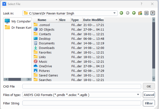

Forum ModeratorWhich version are you using, and where are you trying to read the geometry file? Screen shots will help.Â
June 14, 2023 at 7:05 am
AMIY GOVIND SINGH
Subscriber -
June 14, 2023 at 10:24 am
Rob
Forum ModeratorFluent Solver or Fluent Meshing? Can you open in Discovery and then transfer to Fluent Meshing from the Prepare tab?Â
June 15, 2023 at 5:41 am
AMIY GOVIND SINGH
SubscriberI was trying in fluent meshing,Â
The problem is solved as file extension is not supported for earlier versions, i tried to open in ansys 2023 R1 student and it showed the file extension and the geometry was imported
