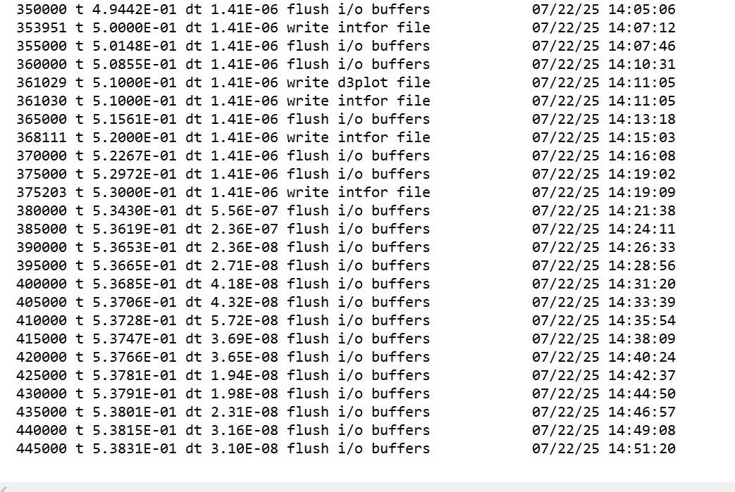

SubscriberThis happens when you have elements that have become highly distorted since stable time increment is dependent on the characteristic length of the element.  You should be able to just plot something and see where this happened.Â
