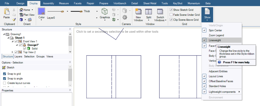

      Hi
      Is it possible to put hidden dashed lines?
      I tried to search in various settings but it does not seem to me.
      I ask for confirmation
      Regards
    • Naresh Patre
      Hello  Roberto
      Go to the Display tab and then click on Show > Lineweight, then the hidden lines will appear as dashed.
    • Roberto
      Many thanks
