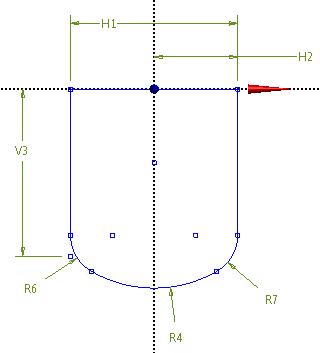

      I would like to draw the geometry showing in the picture by joining the points in Design Modeler. I am facing problem to draw the lower part of the converter (Marking area in the picture). How can I draw this portion by joining two or three points?
      Hello Raju,
      Draw a Rectangle.
      Draw an Arc by 3 Points
      Trim away the line and add a coincident constraint to the end points and center point.
      Draw an Arc by Tangent
      Add Tangency constraint and trim away the corner.

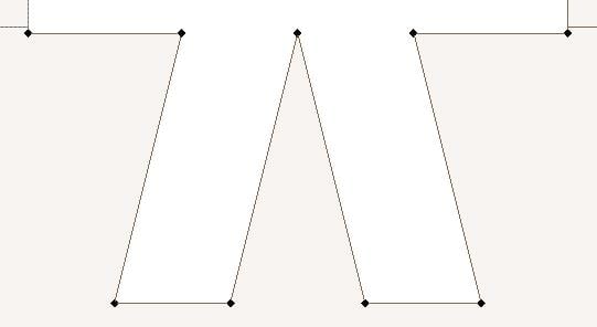

      To draw the geometry, I have select the coordinates by creating points. Then creating lines by joining two points. Problem is that, after connecting all points, when creating a surface from the sketches to create the area of the geometry, the geometry is not selecting. What should I do to create the surface?
      Raju.
      Assuming you have a sealed loop, look in the Concept tools for create face (surface?) from sketch.  Note, it will create the face from the outer loop of edges so if you want multiple faces you'll need multiple sketches.

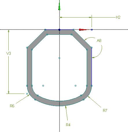

      Hello Raju,
      You say area of the geometry. I assume you want a 2D cross section and not a 3D solid of revolution. One option is to make the 3D solid, then slice it to get the face you want. The other option is to create an offset in a new sketch.
      Then use Concept, Surfaces from Sketches and create two surfaces.
      Then use Boolean Subtract, and use the inside surface as the tool and the outside surface as the target.
      You can even create a slice on the inside surface to represent the contents.
      If you want a 3D solid, I can write that up. If you get stuck doing any of this, I can make a video.

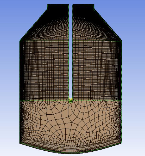

      For meshing, I would like to subdivide the geometry into parts (red marked lines) and want to control the meshing. How can I do this?
      I would like to create rectangular mesh with equal size. How can I do this? I don't want to any triangular mesh. How to remove them?
      I am taking 1000 number of divisions in edges but this does not affects on meshing. How can I solve it?
      Raju.
      Hi Raju,
      You need to create five planes and insert five slice operations. The XY plane of the new planes define where the slice goes.
      Then you will have 9 parts and 9 bodies. In DesignModeler, select the 9 bodies at the bottom of the Outline and RMB to select Form New Part. Then you will have 1 part and 9 bodies.  This is a multibody part and they will have Shared Topology, meaning the bodies share a common edge. When the mesher meshes these bodies, they will share common nodes at the common edges. There is no need for contact to connect the bodies.
      In Meshing, add the Face Mesh control on all faces. That forces quadratic only elements, since each face has exactly four sides. Go to the Mesh Details window and enter the default size for the elements. That should make all the elements about the same size.

      Meshing
      If you Slice with a plane and use multibody part, and Face Meshing control, you will get what you want.
      If you don't, Attach a Workbench Project Archive and I will look at it.

      I have your file and am slicing it up. You said you want no triangles, but that will not be advisable with this triangular point in the center.
      You can also see your Face Split missed the vertex in the corners by a small margin, so I will redo that.
      After slicing, there are 2 triangles in the mesh.
      You said in your other post that you are on ANSYS 18 but do you mean 18.0 or 18.2?
      If I do this in 18.2 you won't be open it in 18.0 so please reply with your exact version.

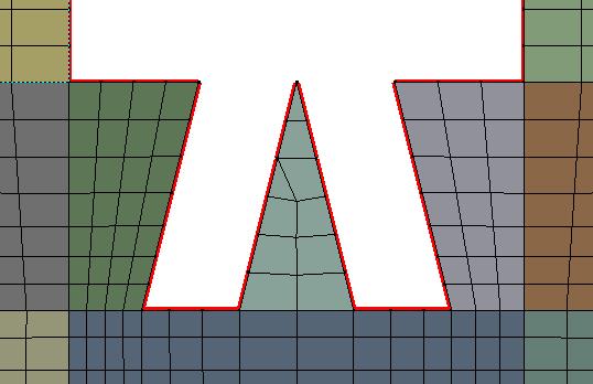

      Here is an ANSYS 18.2 archive sliced up.
    • rumth
      Although there are two triangular mesh is formed, seems good meshing. Did you do it only by Face meshing (all edge meshing seems disable)?
      How do you selected PF Point and Plane Normal. While I am doing, Base point selected from Vertex and Normal defined by 3D edge. It is creating problem meshing.
      Raju.
      The item to select for Normal Defined by is either the ZX Plane or YZ Plane at the top of the outline to make a horizontal or vertical slice respectively. When you filter on Vertex and pick a PF point off the graphics window for the Base Point, it will use the PF Point.
      Yes, all Face Meshing and just setting the Max Face Size in the Mesh Details window in the Sizing branch.
