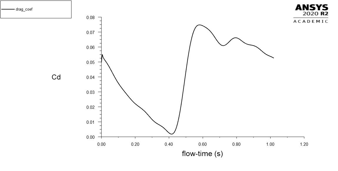

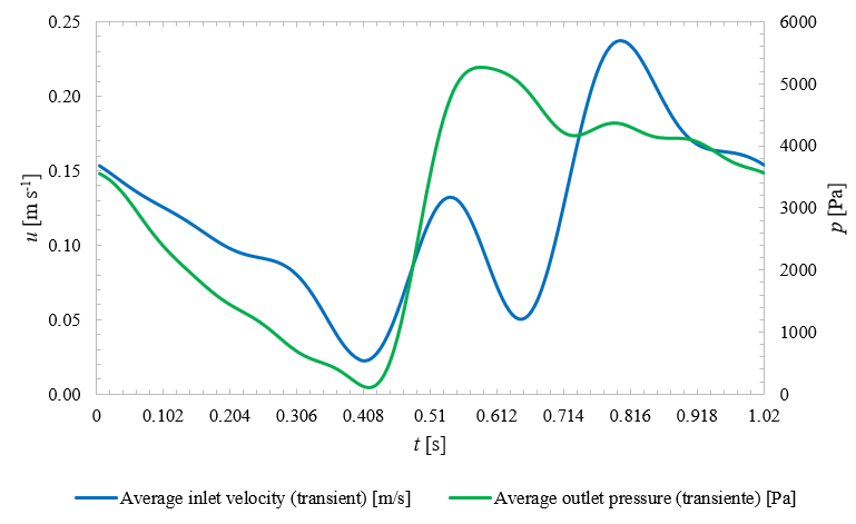

SubscriberHello, I am doing blood flow transient simulation in an artery and I used a UDF for inlet velocity and another for outlet pressure (fig. 1). I want to obtain Cd over time.

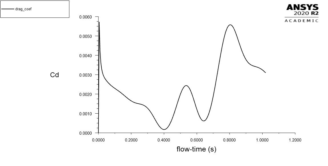

SubscriberWell, the only pressure data comes from the outlet pressure I defined, the reference value of pressure was left as default. In the simulations in which I remove the outlet pressure UDF, I think the outlet pressure is constant and equal to 0.
I plotted Cd over time and obtained completely different cuves depending on the existence of the pressure UDF in the outlets...
Why do you think this is the case? Why does Cd apparently depends so much on the outlet pressure?

Forum ModeratorYou set the outlet pressure, Fluent calculates the inlet pressure (and pressure field) to deliver the flow rate you define.
Read https://ansyshelp.ansys.com/account/Secured?returnurl=/Views/Secured/corp/v212/en/flu_th/flu_th_sec_report_force_moment.html as I think the solver pressure you're using for the force is where it's giving the differences. Plot the inlet pressure for both cases on the same graph as the outlet pressure.

July 21, 2021 at 11:05 amRob
Forum ModeratorWall shear is a function of the flow speed adjacent to the wall, and parallel to the facet so is linked to flow rate.
Drag is a force, so is linked to pressure (force/unit area).
In your case you'd look at the pressure loss in the system, and also wall shear. The former may imply a restriction (constriction) in the vessel and the latter may suggest a greater risk of an aneurysm. There are references to this somewhere as I've read (and helped with) projects of this type.
