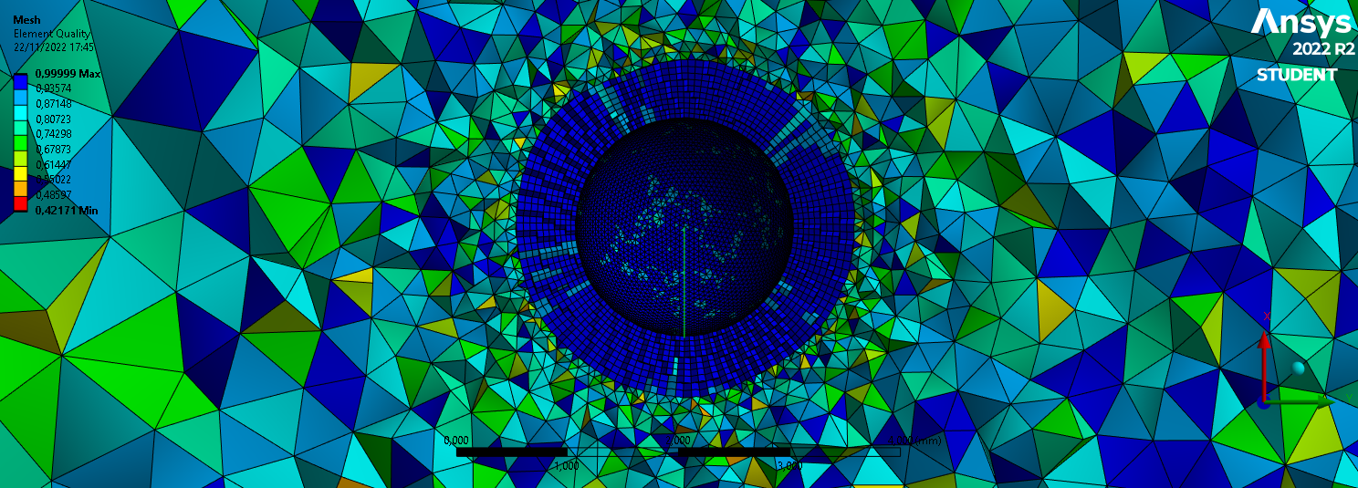

      How good is your mesh near the object (ball)? Can you post the screen grab of the cut section of the volume mesh?
      • charles-web
        here the mesh near the ball :
        here at the middle of the ball :
    • Nikhil N
      This doesn’t look like a cut section. Did you add inflation layers?

      For getting accurate results, it is very critical to have a mesh with good resolution and quality, at least near to the object of your interest. I would suggest you to look for aero meshing tutorials (airfoil for that matter) on the internet.
      Also, keep a keen eye on the y+ value and make sure to maintain it as per the best practice. To know more, check this: 4.18.1. Overview (ansys.com)

      Use inflation and resolve the wake region. The graphs will show you the quality of the cells, what you're lacking is resolution of the boundary layer, separation and wake regions. Read the Body of Influence part here https://ansyshelp.ansys.com/account/Secured?returnurl=/Views/Secured/corp/v222/en/flu_ug/tgd_user_sf_types.html%23tgd_user_sf_boi  to show how I'd mesh this. In Ansys Meshing the functions are there, but the images are better in the Fluent Meshing documentation.
      The data you get from your model will not be accurate, but the general principle is shown.

      i did another one mesh :
      i let my body of influence around my ball (radius ball * 1.2), kicked out the refinement method, and add a a pre First-layer-thickness inflation method with growth-rate set to 1.5 and try to keep all cells quality,
      what do you think about it ?
      Better. You may find you need more mesh via a BOI in the wake and more inflation layers but give it a go.

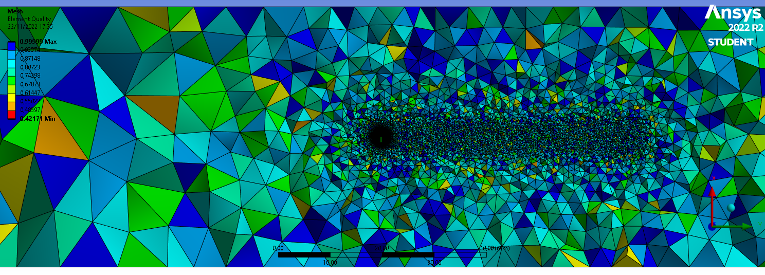

      make a better refinement/cell quality using BOI in the drag region like in this picture
      [edit] how can i add quote to my post here ?
      Yes, like the image. You may not need to go as far downstream though.

        ok but the probleme is how can i make a sphere of influence shaped like an ellipsoïd ?
      Create a block & chamfer or curve & rotate: you do this in SpaceClaim or DesignModeler.  As it's just a shape to guide the mesh refinement it's not required to be a perfect shape - a cuboid wedge will be fine.

      i maked this new one :
      does it seems better for you ?

      Given how coarse your new mesh is, how big a jump in cell size over the interface and how close it is to the region of interest, then no, it's not better. Have a look at the airfoil/aerofoil tutorials (might be NACA) and see how they've been meshed. Then read up on body of influence as you've split the zone out.

      and this one ?
      are mesh order feature important ?
      is there a way to compare 2 meshing quality/skewness/aspect-ratio graph ?
      [EDIT] thanks for information about updating post ^^
      Much better. The order shouldn't matter as the tool ought to take the smallest cell from each: it's why it takes some time before building the mesh.
