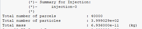

      Hi-Also when Fluent say Particle Variables, does it mean individual particles or parcel? Also when we display Particle tracks does it display the trajectory of the parcel or individual particles? This is because i thought parcel is a collection of particles but when i do Report>Summary then it is showing something confusing where the particles is showing less than parcel numbers. Can someone please clarify? I have attached the picture.
    • scabo
      Hi-If someone can answer the above query-many thanks
