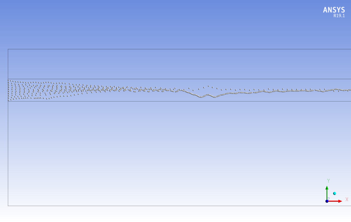

Luigi0
SubscribernnIn the first image the trajectories referred to the first part of analysis are shown. Particles enter from the inlet (on the left) and go to the right. (The flow is laminar)nIn the second image the trajectories of the particles referred to the second part of the analysis. My problem is related to the fact that also the initial trajectories change, but the analysis is restarted from last time-step of the previous analysis part, and not from the beginning.nn

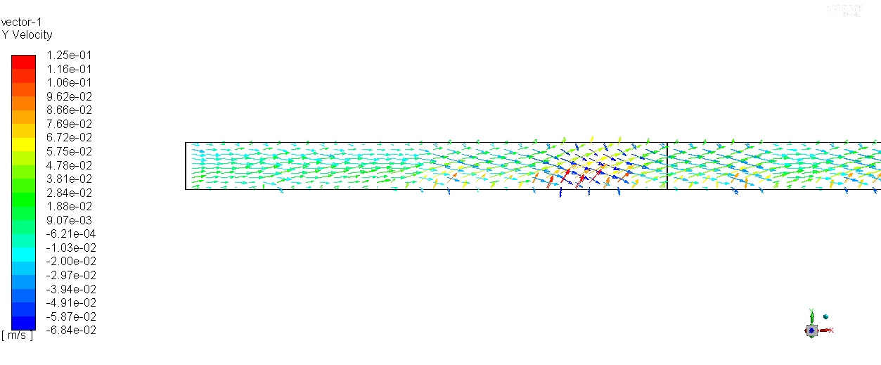

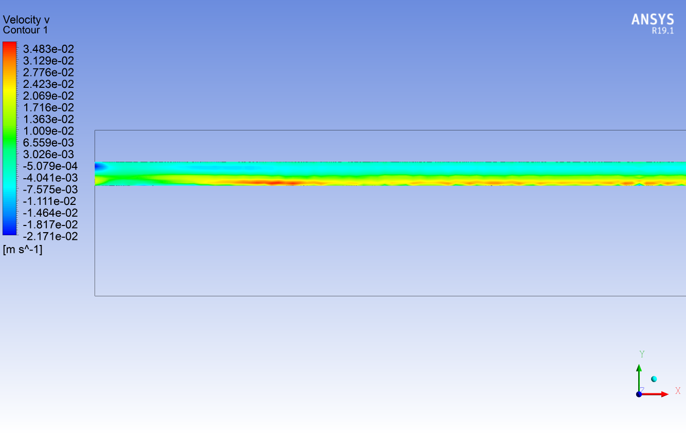

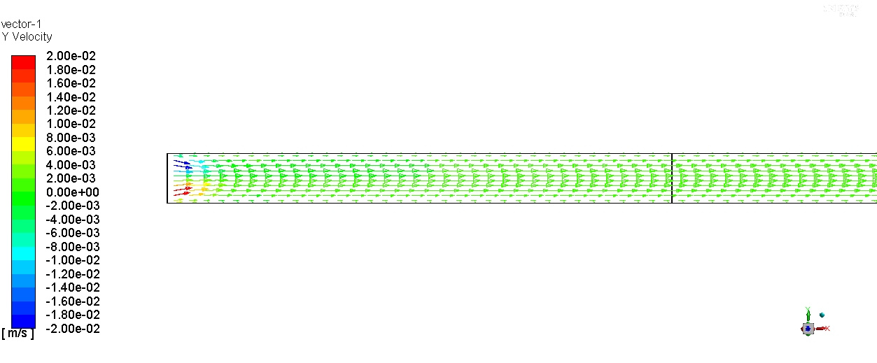

October 19, 2020 at 4:51 pm
Luigi0
SubscriberYes, the first picture shows the contour plot of Y velocity at end of the first part of the analysis.n
The second image shows the the contour plot of Y velocity at end of the second part of the analysis.n
The third imageshows the the vector plot of Y velocity at end of the first part of the analysis.n
The fourth image shows the the vector plot of Y velocity at end of the second part of the analysis.n
Sorry for the different post processing method : the first two are obtained with CFD post, the last two with fluent post processing. (In CFD post I am not able to plot the component Y of velocity as a vector plot).n
October 20, 2020 at 11:23 am
Rob
Forum ModeratorLooking at the y velocity it's up in the lower half and down in the upper half of the domain in the second set of results. With that information what would that do to the particle positions? In the first result y component is zero or near enough zero. n -

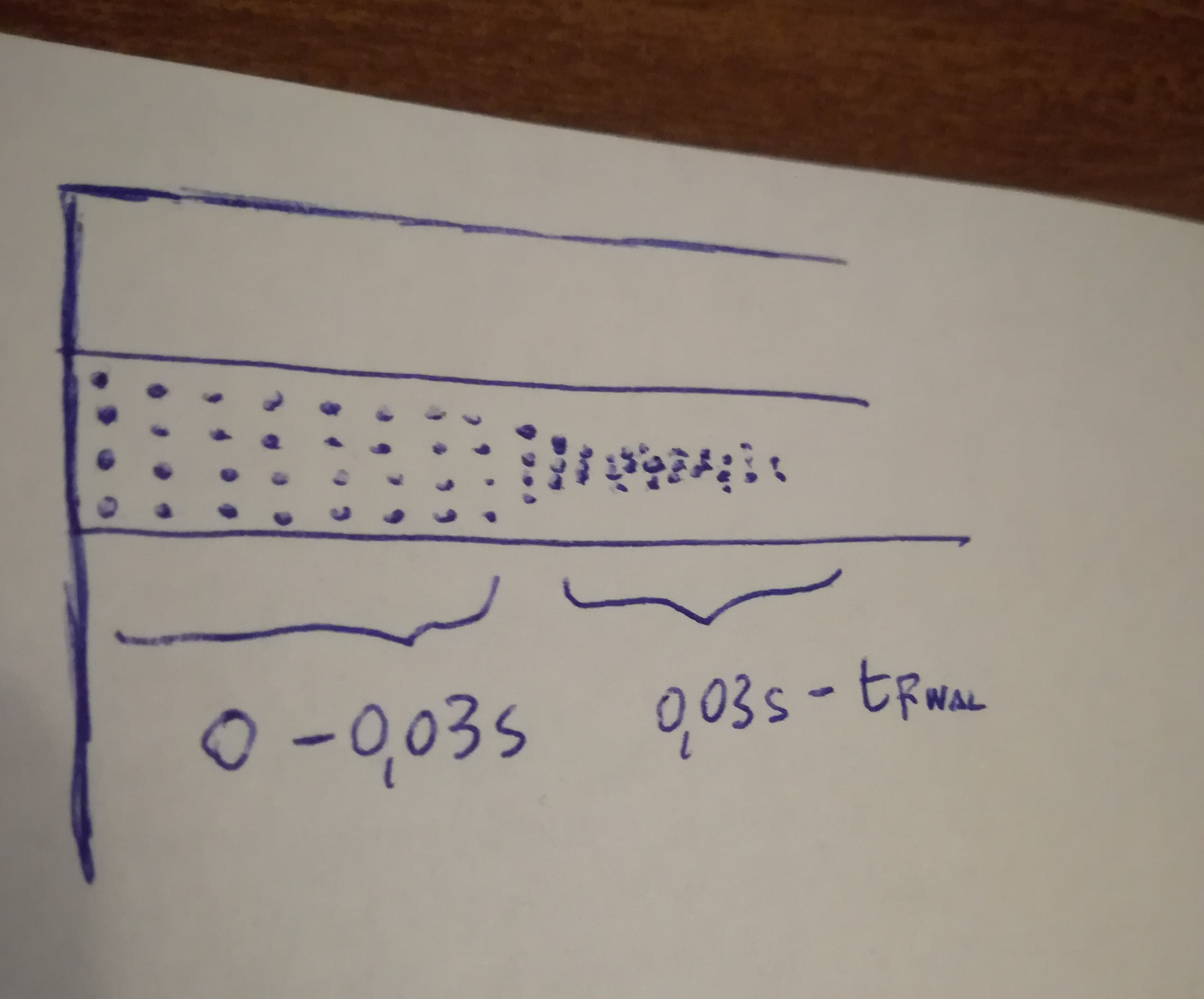

October 20, 2020 at 4:42 pm
Luigi0
SubscriberThe second DPM image is at the end of the analysis (t = t-final). I expect a situation like the sketch below:n
After 0.03 s particles should concentrate in the center, but the trajectories before 0.03 s should remain straight as in the first DPM image that I sent. Maybe I'm confused concerning dpm tracking or representation: I inject 10 particles (parcels), one per cell (I have 10 cells on the inlet), so the remaining that are present in the DPM's images that I post are not physical particles but they only represent the trajectory, am I alright?n

October 22, 2020 at 9:59 am
Rob
Forum ModeratorThe particles you see represent the parcel location, so are where the particle would be. If the whole flow field is affected by the new velocity field the particles will behave as per the velocity field: it'll take a bit of time hence the particles taking some time to contract towards the middle. The particle tracks look about right for the flow field, so I think you're getting an explainable result. n -
