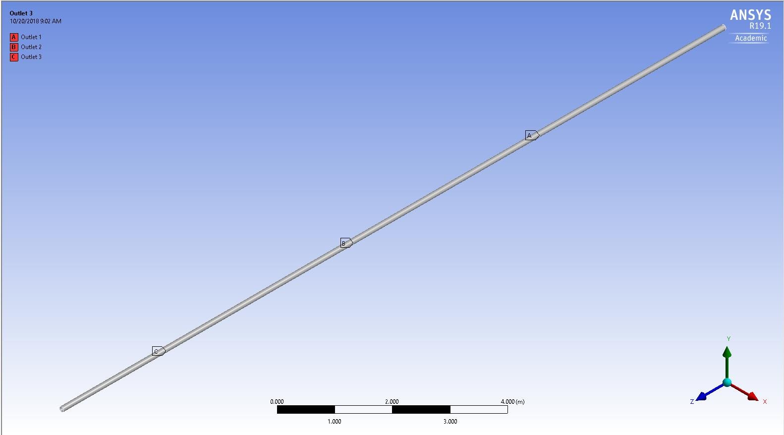

I'm trying to model the flow of water and sand in 3D pipe with three side openings ( perforations) as shown in the following picture. The three holes are marked with the letters (A,B,C) and the other side of the pipe near hole C is plugged. The first objective is to estimate how much sand will escape from each hole.
Case Parameters:
Inlet (velocity-inlet B.C) with velocity = 8.617 ft/sec and reflect DPM B.CÂ
outlet (pressure outlet B.C) with 0 gauge pressure and escape DPM B.CÂ
Sand Injection is at the inlet face at the same velocity of the fluid (8.617 ft/sec) at flow rate of (22.4 lb/sec)
I'm having difficulty to get a converged solution using DPM without DEM collision and with steady particle tracking. Allowing DEM collision and tracking the particle in unsteady mode seems to be easier to get a converged solution but I have not gotten any yet.

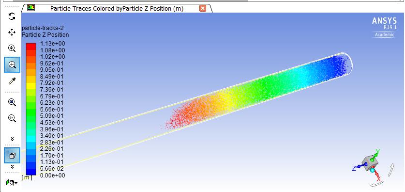

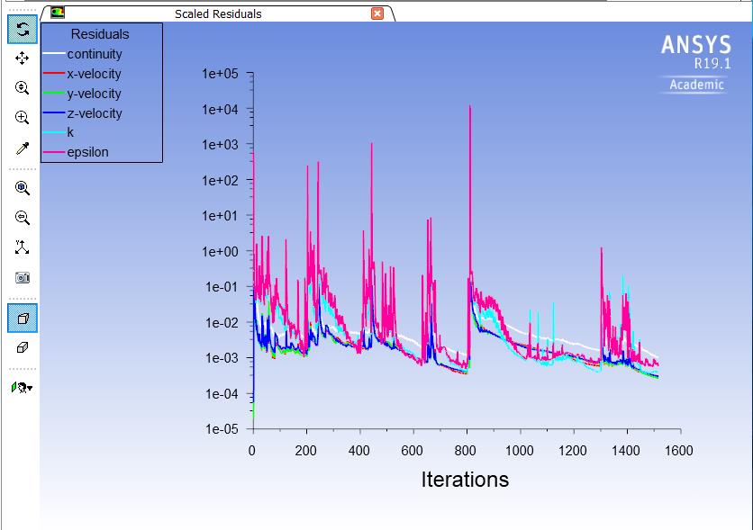

SubscriberHere is a DPM case that I'm trying to solve.
I get a convergence when I use a 0.15 lb/sec mass flow rate as shown below:

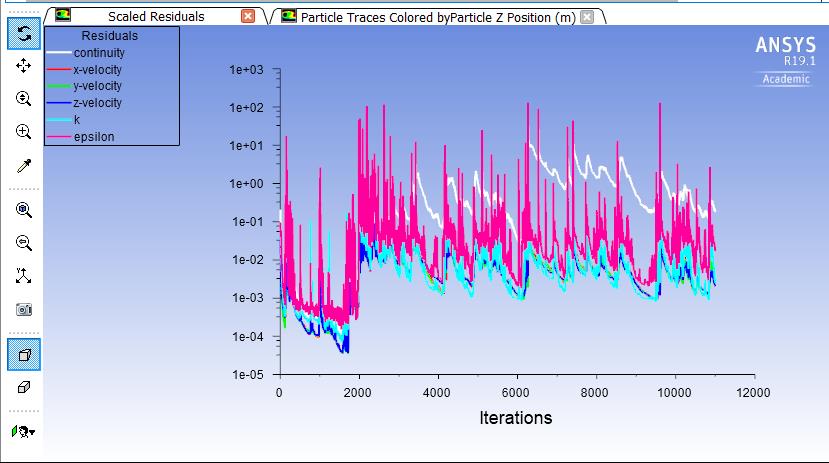

When I increase the mass flow rate to 1.5 lb/sec (at iteration 1500), the solution does not converge and I get "floating point exception" as shown below:

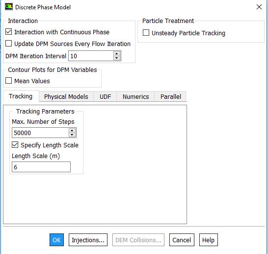

This is the way I setup the DPM:

Ansys EmployeeSwitch on update DPM source every iteration, increase number of continuous iterations per DPM and reduce DPM Underrelaxation and run for much more iterations: first steps to sort problems out.Â
ps: even the case at low loading the run is not converging at all from residual perspectiveÂ

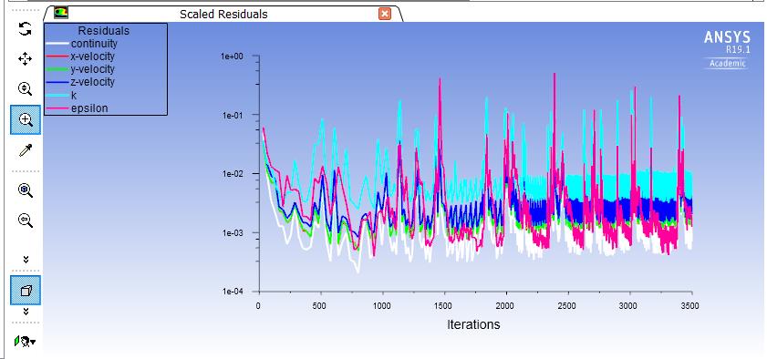

This is the status of an ongoing re-run of the high loading particles (1lb/sec) with the parameters you suggested. I'm using a 0.3 underrelaxation for DPM.
it is now around 35k iterations and still there is no convergence. Do you think it needs more iterations to converge ?
The following snapshot is for the early time. 0.15 lb/sec particle flow rate until 2000 iterations. is this still not converged for the low loading using 1e-3 residual criteria ?Â

Ansys EmployeeThat is kind of non-converging case. Can you please describe a bit your case and share with us all information regarding boundaries, settings and co?Â

DPM as shown below:
Let me know if you need additional info

Ansys EmployeeSo you need to find now a biasing between the DPM Source Terms URF and number of update.
You can run transient for enhanced stability. 7% Volume fraction at high mass loading requires the resolution of particle-particle interaction but you can tackle that stage after you are able to run a fine DPM run.
