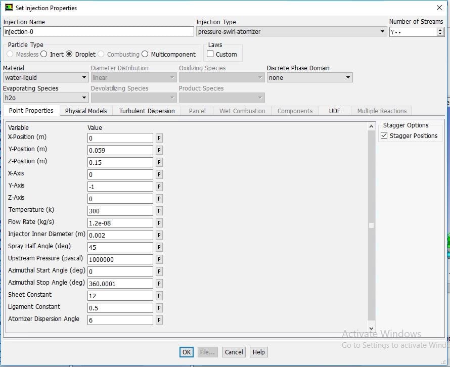

SubscriberHi,nnI am working on spray cooling.I want to spray water in a compressible flow.The stagnation pressure is 4Mpa and static pressure is 0.696Mpa.I set operating pressure to zero and i enter 4Mpa and 0.696Mpa in pressure inlet boundary conditions.I enabled species transport.In materials for mixture template, i select ideal gas for density, mixing law for Cp and Sutherland Law for viscosity.I use pressure swirl atomizer.nnAt the beginning of injection i recieve this error:# Divergence detected in AMG for pressure coupled: protective actions enabled!nn# Divergence detected in AMG for pressure coupled, temporarily solve with BCGSTAB!nnError: Divergence detected in AMG solver: pressure couplednnWhat should I do?what is wrong?.nnRegardsnnMiladn -

Subscriberpaper: Numerical investigation of droplets-gas mixing performance in depth adjustable underwater launcher cooling chamber - Â https://doi.org/10.1108/EC-09-2017-0343nNo i am not able to inject using surface injection.nI should say after that error i get another error:nError: Invalid cp (0.000000e+00 J/kgK) for oxygen at temperature 1.#QNAN0 Kn I set Cp in material as mixing law.what is wrong with cp?.
I have four pressure swirl atomizer like this.n

Forum ModeratorIf air is an ideal gas, where is the oxygen coming into the model? How many particle streams have you got? n -
November 18, 2020 at 2:38 pm
Milhm
SubscriberMy particles are droplet .I think to enable the droplet in injection settings, i should enable species transport. Is it correct?nI assumed 200 particle streams for any injection.n -
