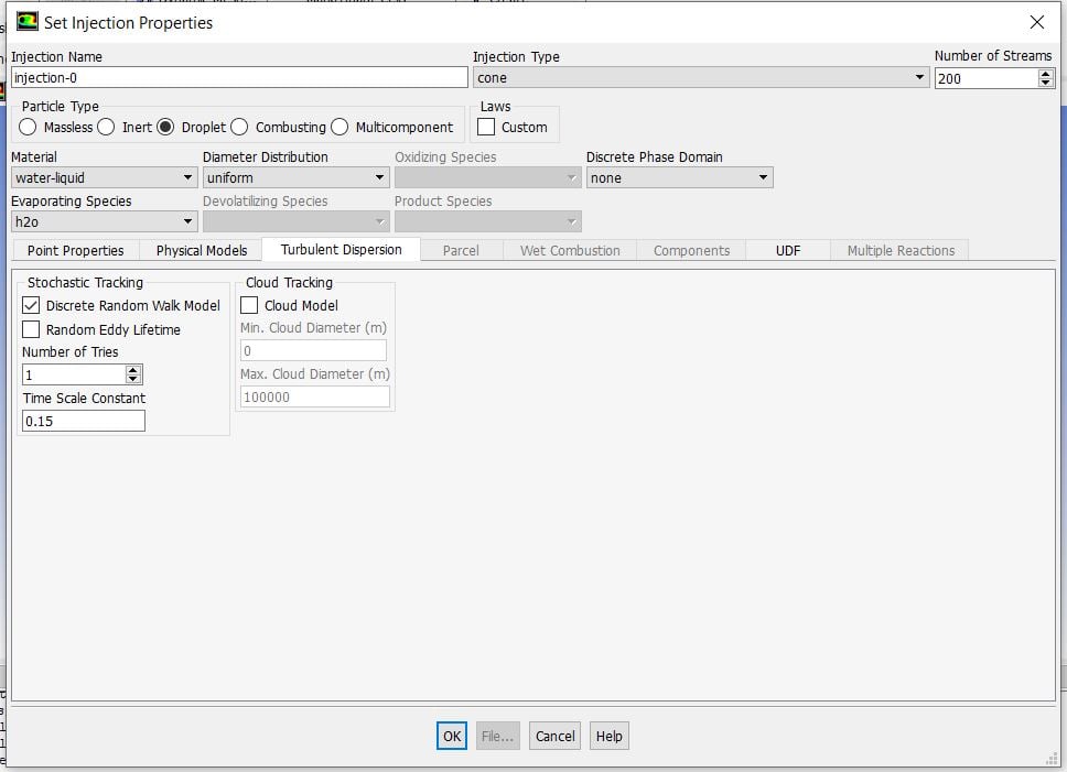

      Hi,nwhat is the best value for number of tries in discrete random walk model when simulating steady state injection?n
      The purpose of the option is to allow the parcels to disperse due to turbulence. If you have a large number of parcels from the injection then fewer tries may be needed, if you have few parcels from the injection then you need more tries. There is also an upper limit on the number of tries based on your hardware. Somewhere between 1 and 1000 is fairly common, 10-100 may be a good starting point. n
    • Milhm
      i have 200 number of streams and my droplets have constant diameter of 20 micron.Which number of tries is good for it?n
      How big is the domain, are particles passing through or are you seeing incomplete tracks? n
    • Milhm
      domain is a pipe with diameter of 260mm and lenght of 4 m.particles are sprayed into the pipe.nno i do not see incomplete tracks. n
      In which case keep increasing the number of tries until whatever you're monitoring stops changing or the computer falls over. Save before plotting particle trajectories! My earlier comment about 10-100 tries being a good starting point stands. n

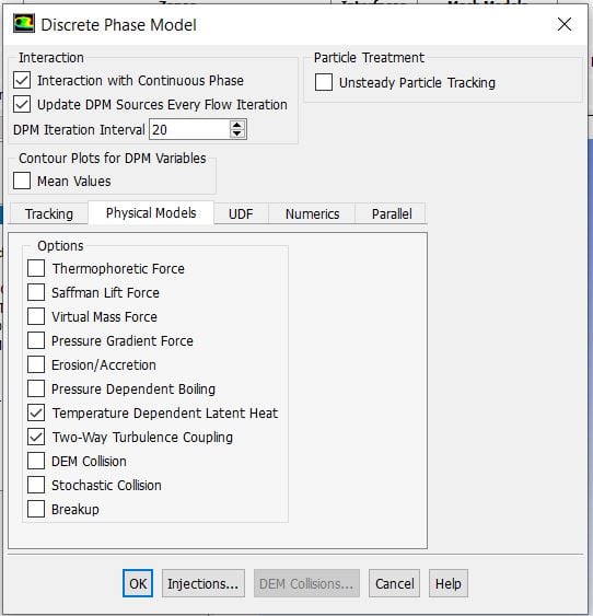

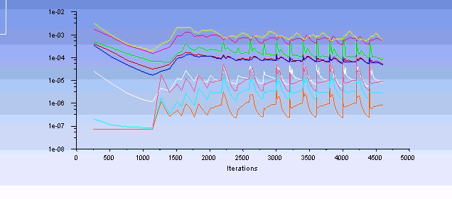

    • Milhm

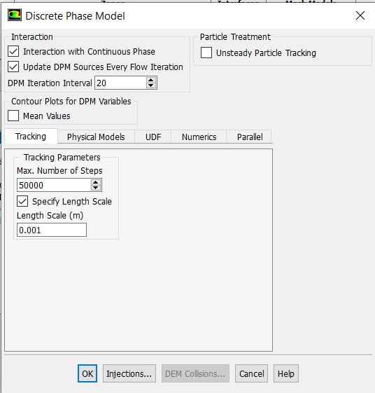

      ok i will enable automatic accuracy controls.nso far i enter 0.001 for length scale.is it logical and correct?ni have another question.in steady injection, residuals become periodic due to dpm iteration interval.is it correct?n nn
      The value isn't nonsensical, but read the documentation to see what it means. Several values we use as defaults are numerically sensible rather than being correct for a particular case. nYes, the residuals will spike with every DPM update as the source terms are updated. n
    • Milhm
      ok.nwhat is the logical value for dpm iteration interval?I use 200 so the residual plot become horizontal in each interval.should i increase this value?n
      On each DPM update Fluent re-calculates the particle trajectory and hence source terms (how much the particle alters the flow). If the update is very frequent the solution may never converge, and may use a lot of cpu resource, on the other hand the solver is using the correct DPM data. If the interval is very long, you'll see spikes, use less cpu but risk using less up to date data. Both high and low intervals are valid depending on how much of a change you see in the particle tracks and how much cpu you have. Default is 10, and 10-50 is a common range, I often use the default. n

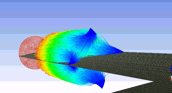

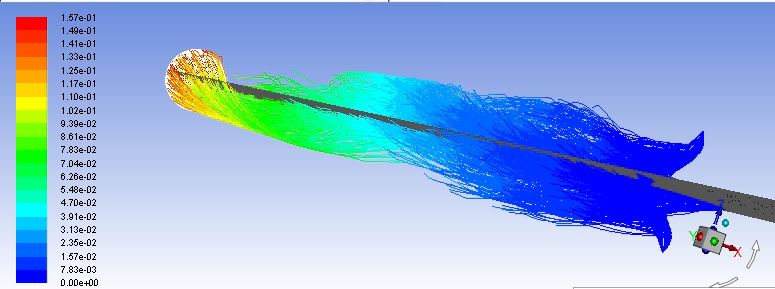

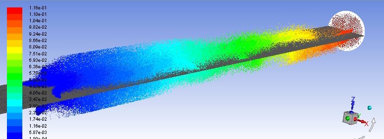

    • Milhm
      in my simulation,when i use steady injection,particle tracks rotate and sweep.nand when i use unsteady injection, their distribution becomes disordered.n and leed to wrong contours.in your opinion where is the problem?n
    • Milhm
      in my simulation,when i use steady injection,particle tracks rotate and sweep.nand when i use unsteady injection, their distribution becomes disordered.nnand leed to wrong contours.in your opinion where is the problem?n
    • Milhm
      in my simulation,when i use steady injection,particle tracks rotate and sweep.nand when i use unsteady injection, their distribution becomes disordered.nnand leed to wrong contours.in your opinion where is the problem?.
      Looks about the same to me. In steady tracking you see a solid track that is the trajectory. In transient you see the location of each parcel in the domain. So, in the first image you see lines, in the second a cloud of spheres, joining the spheres up based on their injection facet will produce the line you see. n

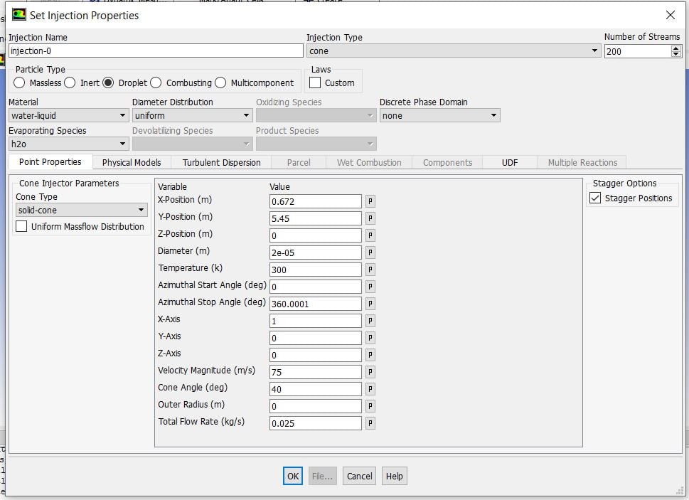

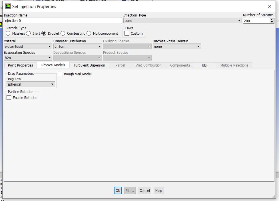

      Can you post the injection set up and similarly the inlet condition panel? n
    • Milhm

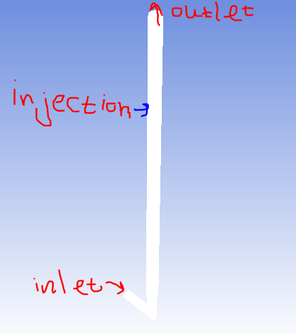

      the problem is an L shaped pipe.material is air.it is assumed as real gas.inlet boundary condition is mass flow inlet. and outlet is pressure outlet.nsomewhere near outlet injection is done.nnn
      If the flow is in the y direction why is the injection in the x direction? n
    • Milhm
      it is injected through center of pipen
      At 90 degrees to the direction of flown
    • Milhm
      yesn
      And you expect the droplets to go straight towards the axis and then be deflected by the main flow? Now you explain the set up, I take it you have 3-4 injections each doing this? n

      i have four injection which are placed radially.ni expect droplets go in a straight way through outlet without rotation of particle tracks about axis.i expect something like this imagenn
    • Milhm
      this is vector plots of main flow in different cross sections.as can be seen from the image,main flow is rotating.Can it cause particles to rotate?nnmain flow has mass flow rate of 1.1 kg/s and temperature of 600 k.it is solved as a compressible flow.operating pressure is 101325.gauge pressure in pressure outlet boundary conditions is set as 0.nafter flow is solved,ndensity is about 0.57,ninlet velocity is about 60 m/s,nin the elbow velocity is about 110 m/s,nbig part of domain has velocity of about 50 m/s,nmach number is between 0.004 to 0.25.nare they correct and logical?n
      The injections will flow as per the vector you initially set. Any slight distortion in the flow or mesh will tend to trigger a very slight eccentricity, this then cascades to generate small amounts of swirl. Have a look at the pitchfork bifurcation phenomena. In your case the inlet being off axis may be be enough to trigger the effect. n
