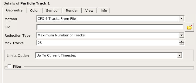

Forum ModeratorCan you plot where the particles are? I'm wondering if you have droplets throughout the refined region. nOctober 21, 2020 at 6:14 pmparth144
SubscriberI'm not able to track the particle. It requires some file to upload it. nOctober 21, 2020 at 6:15 pmparth144
SubscriberAny other guess why it's creating problems?nOctober 22, 2020 at 12:27 pmRob
Forum ModeratorIn Fluent, under Results look at Particle Tracking. Then see where the particles are. nOctober 28, 2020 at 4:30 pmOctober 28, 2020 at 5:02 pmRob
Forum ModeratorNot in Fluent it doesn't, hence look in there. nDecember 2, 2020 at 6:49 pmparth144
