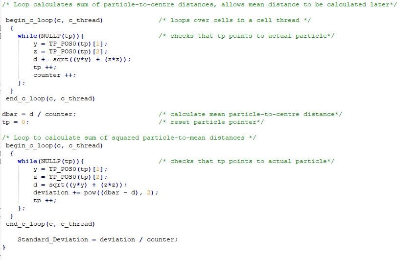

Option 1: I can use
DEFINE_DPM_OUTPUT(name,header,fp,tp,t,plane) to access the tracked particle data and write it to a .dpm file. I could then use another function to read this file and do the calculations I need. But how do I automatically create the .dpm file at the end of each design simulation?
Option 2: Call
DEFINE_DPM_OUTPUT(name,header,fp,tp,t,plane) inside of an EXECUTE_AT_EXIT macro to do everything at once. But with this option, how do I pass the arguments (header, fp, tp, t, plane) from fluent into the DPM_OUTPUT?
Option 3: Use the DPM data access macros PP_POS(p) inside a function which loops over all cells on the plane and all particle streams in the injection. I have tried to implement this in the image below. The code compiles but doesn't execute correctly, it doesn't seem to run through the innermost loop at all. I have also tried using PP_POS0(p) instead, but this gives a compile error. (error C2109: subscript requires array or pointer type)

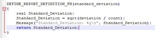

Thanks for the advice, I see now why I would have to use DPM_OUTPUT. I am using Ansys 19.2 so I think I have to use DEFINE_REPORT_DEFINITION_FN instead, is that correct?
My code can now compute the value I need, but when i try to return this to fluent it returns nan instead. I also included a Message output in the code and even though I only included it once it returns 2 messages with 2 different values, first it returns -nan(ind) then returns the correct the value. I included this code below. Do you have any idea why this is?
February 8, 2019 at 12:41 pm
DrAmine
Ansys EmployeeThe macro I was talking about is DEFINE_OUTPUT_PARAMETER but DEFINE_REPORT_DEFINITION_FN can do the same.
I cannot tell you why you are getting "nan", as you are only showing the screenshot of this macro. You need to restrict the calculation only at host as I imagine the values are only available at host. Perhaps division by zero.. You need to debug.
