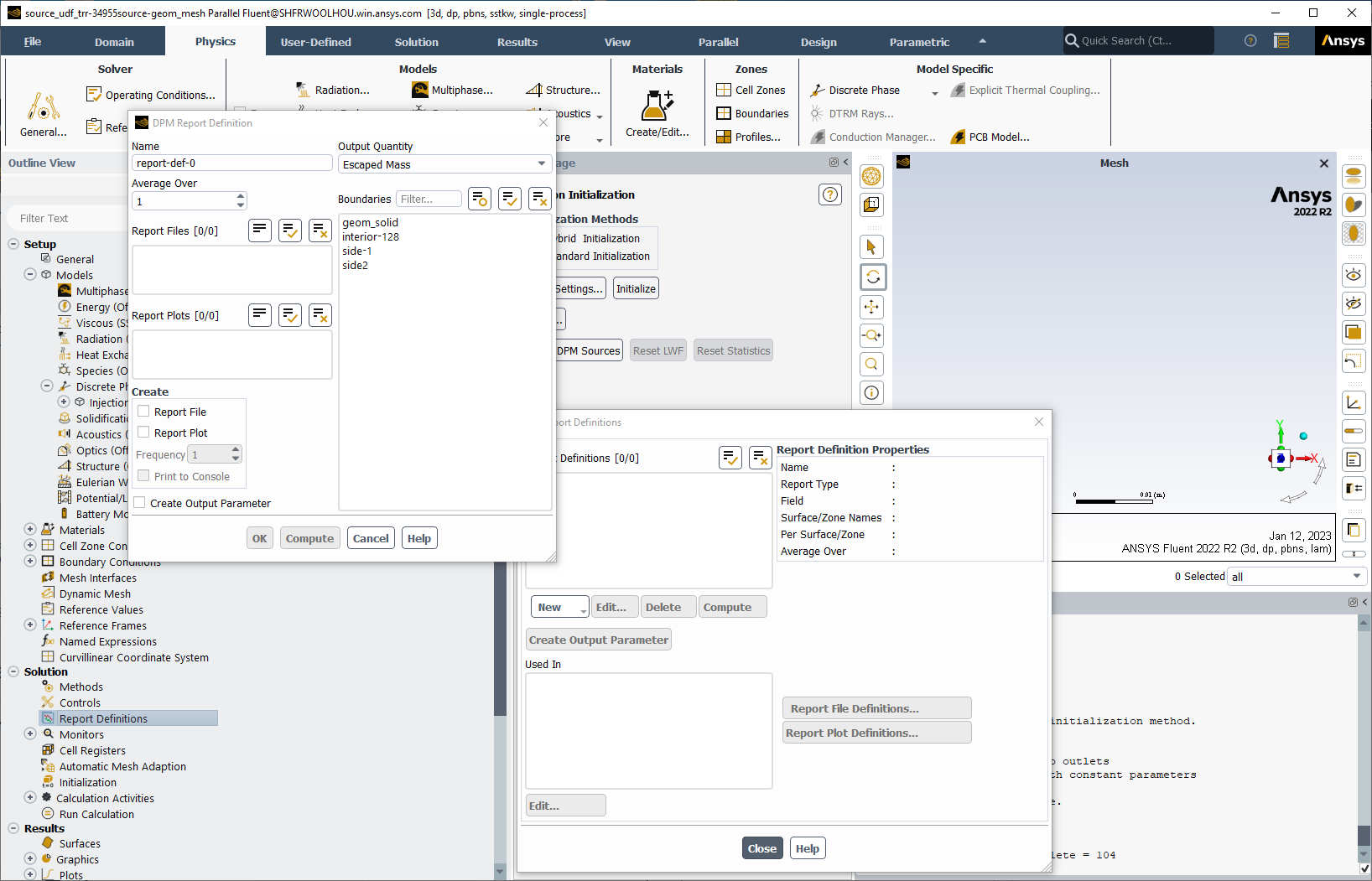

      Hi I still got some confusions about the particle numbers passing through that specific outlet. I tried looking into Reports>> Discrete Phase>>Summary-unavailable. Could you please provide me more insights about this topic?
      You need to create the sample, and then that should read in as a Histogram. Or use the Report option, double click on Report then New as the DPM option is greyed out sometimes.
    • sapkotadpak

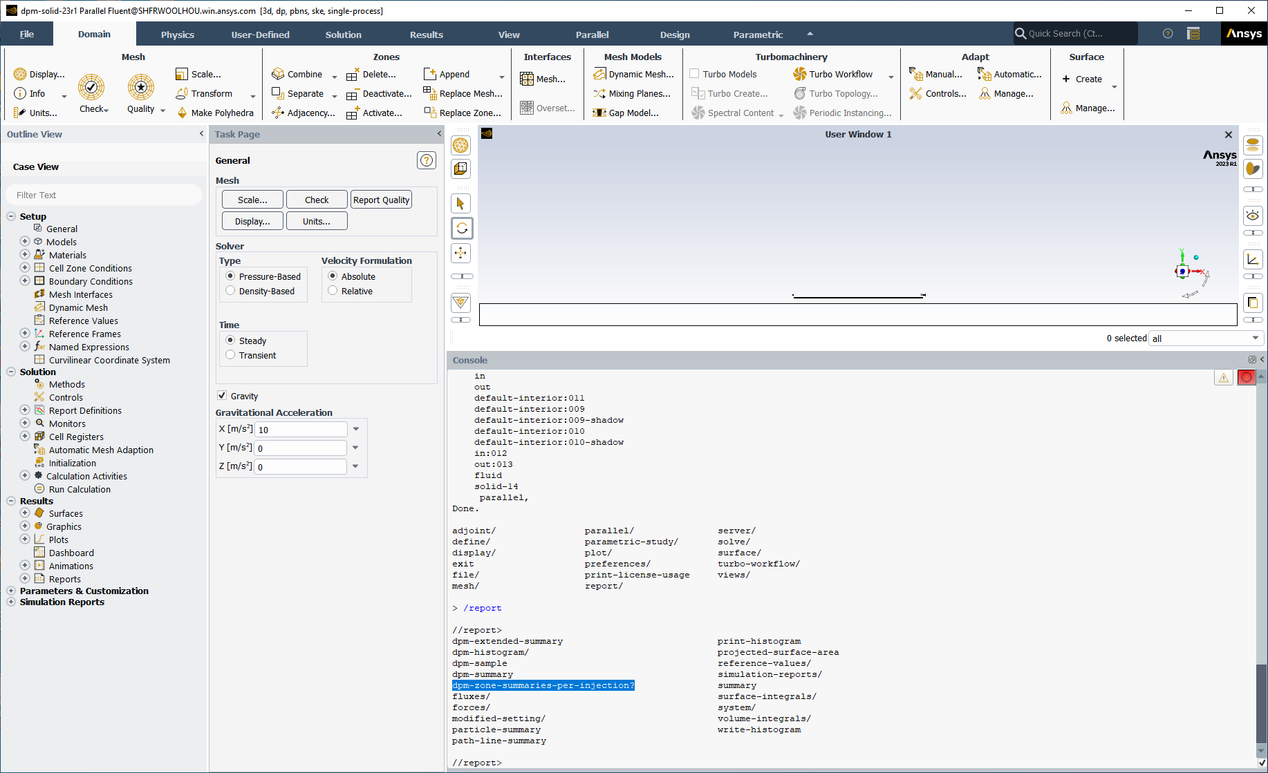

      Thank you for the clarification. While clicking on the report, I now have the information on escaped mass in kg/sec. How to get this value for different injections?
    • Amine Ben Hadj Ali
      With Text User Interface Command (TUI), you can enable output per injection (under /report).
    • sapkotadpak
      I dont know about the command. Could you please help me with this one? Is there any tutorial /video for this?
      I doubt there's a tutorial on this, I did write it up as a solution but that's not public domain at present.
