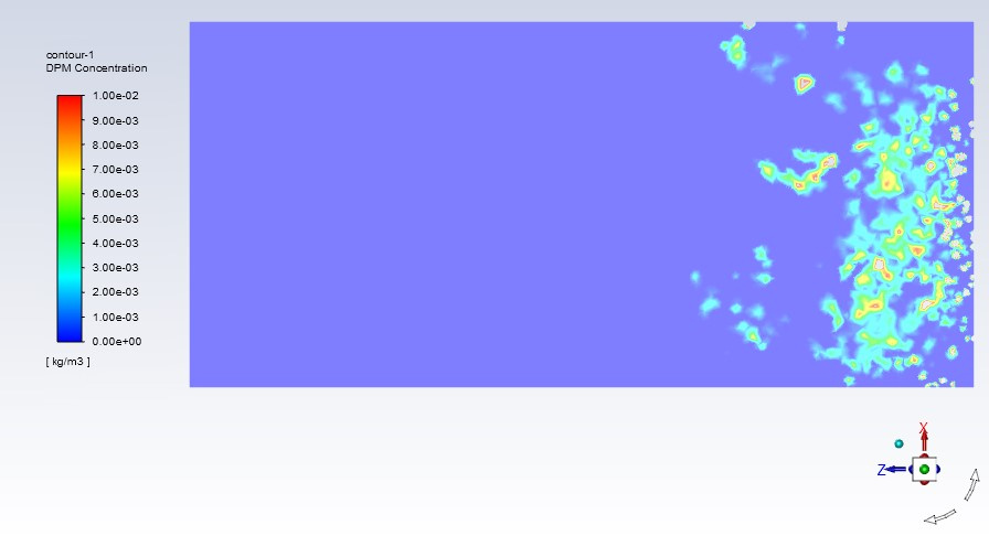

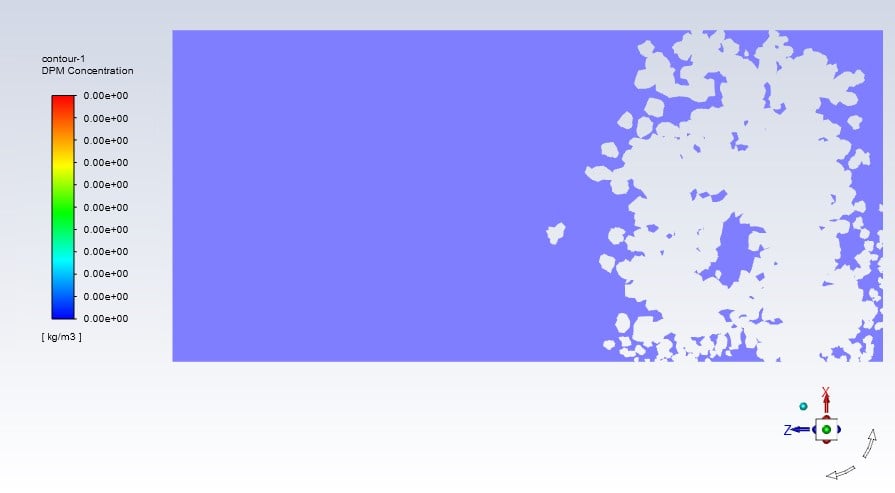

Forum ModeratorLook at the display range, if you set the first image range to 0 to 1e-2 I suspect you'll see something like the third image. nSeptember 23, 2020 at 3:28 amSeptember 23, 2020 at 2:37 pmRob
Forum ModeratorThe holes in Fig 2 are regions where you've clipped the display range: if you turn off clip to range you'll see those areas in red: they're regions with a value higher than 1e-2 kg/m3. nFig 1 is displaying the concentration, it's just the bulk of your region has a concentration under 1.7e-2 kg/m3 with the revised scale in Fig 2 you can see it.Viewing 3 reply threads- The topic ‘DPM Concentration on Auto Range or Clip to Range in Contours in Fluent’ is closed to new replies.
