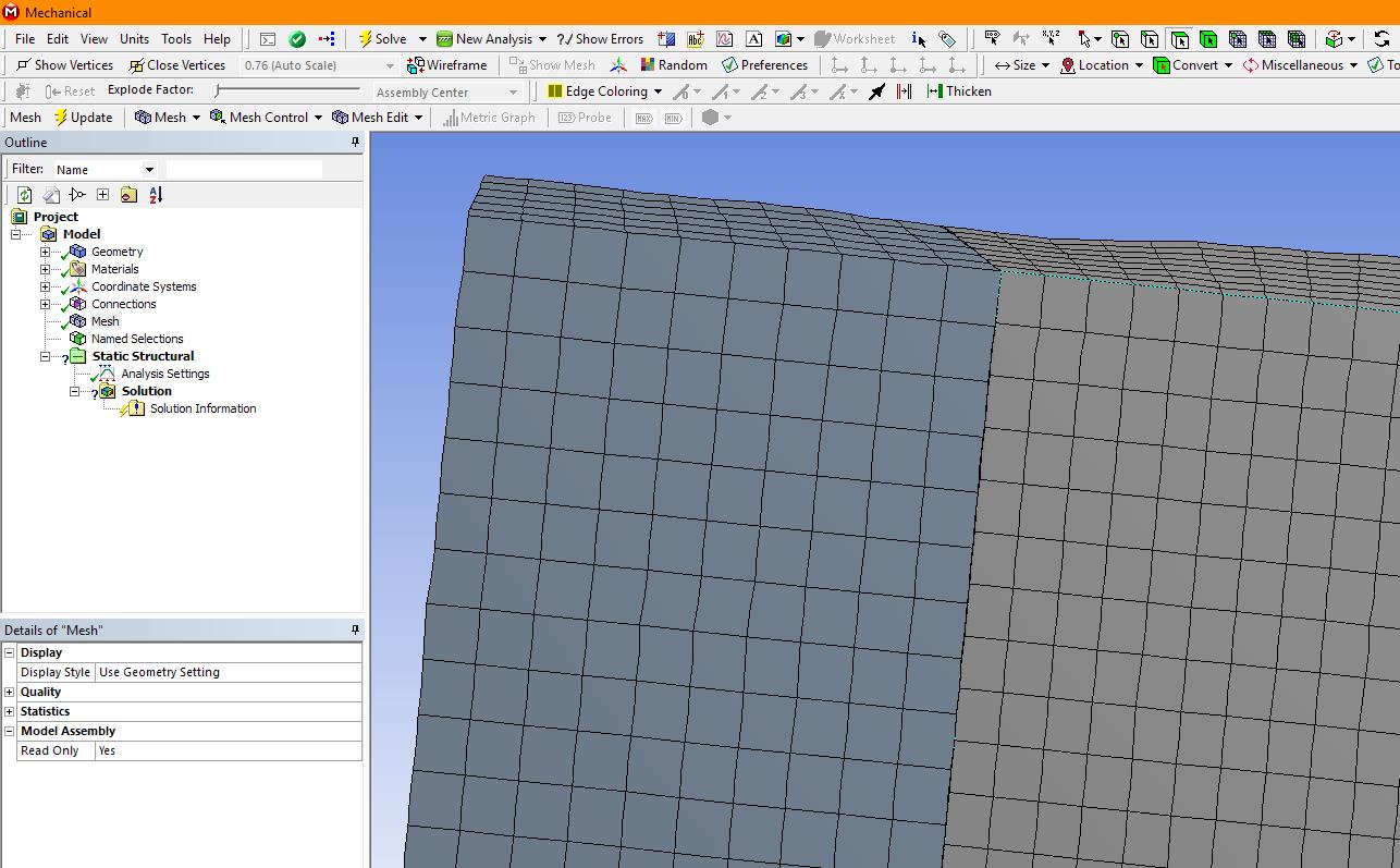

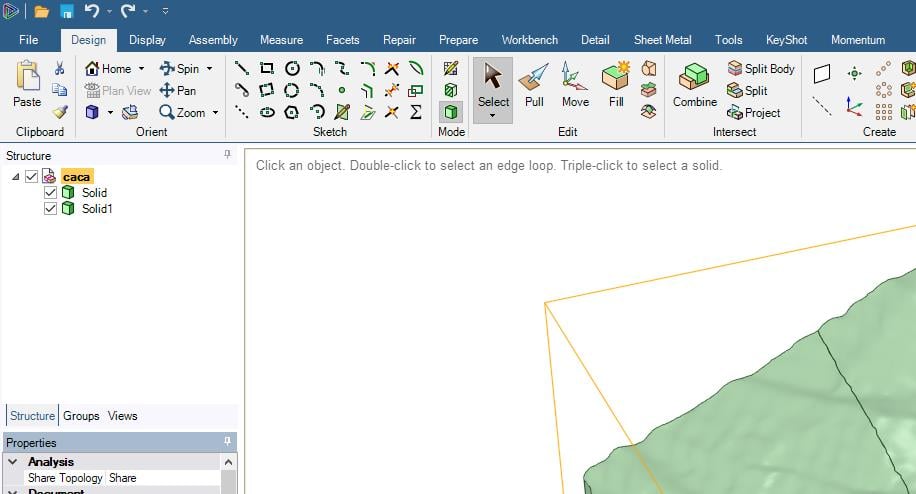

      Well, I imported my geometry to spaceclaim, from my desktop shortcut. I had the 'workbench' tab there, and I could share the topology. Then, I opened the saved spaceclaim file from Ansys AIM and well, I meshed the model and it didn't share nodes... I tried to edit the topology in spaceclaim from Ansys AIM and I didn't have the option of shared topo as I said before.
      So this is basically how my Spaceclaim looks when I open it from AIM:
      As you can see I don't have the workbench tab, nor keyshot nor momentum.
      But when I open Spaceclaim from my desktop shortcut:
      As you can see I have everything there... all the tabs, icons, etc. Also I shared topo there, but as I said before, when i meshed it, it didn't have nodes in common. And whenever I open Spaceclaim from AIM in the properties tab I don't have that 'Analysis' option that gives me the chance to share topo.
      This could be a minor issue if AIM detected that I already shared topology in Spaceclaim (shortcut) but it's not working that way either... perhaps this is due to the fact that opening spaceclaim from AIM, doesn't give me the option to share topology anywhere.
