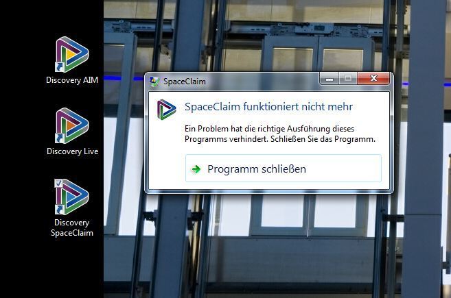

SubscriberHello moderator, I have just downloaded the ANSYS Discovery Ultimate package (version 19.1, released 14 May 2018) and installed it on a computer where ANSYS has never been installed before. Unfortunately I don't get the software to run but I only get the attached error messages. What do I do wrong or what do I have to do to get the software to work?

Ansys EmployeeRaimund Blankenburg Are you getting this error while launching Discovery SpaceClaim as well as Discovery Live? Did you run this graphics card compatibility tool to ensure that your graphics card is compatible with Discovery Live? Secondly, can you send following files to Discovery Support Team: 1. Type %temp% in Windows Search and go inside .ansys folder. Locate .log file starting with ansysls_client* and send it 2. Send following log files located at ~/Ansys Inc Install.log Install_licconfig.log Install.err (if it exists) Lastly, did you try launching Discovery AIM it to make sure that the activation is successful and there are no firewall/proxy issues that are blocking the connection to the server for activation? Please check out this forum post on Firewall and proxy settings required to unblock ANSYS Discovery Products -

Yes, I always get the same error message.
I have executed the “graphics Card compability tool”. Screenshots are attached to the e-mail to the support team.
