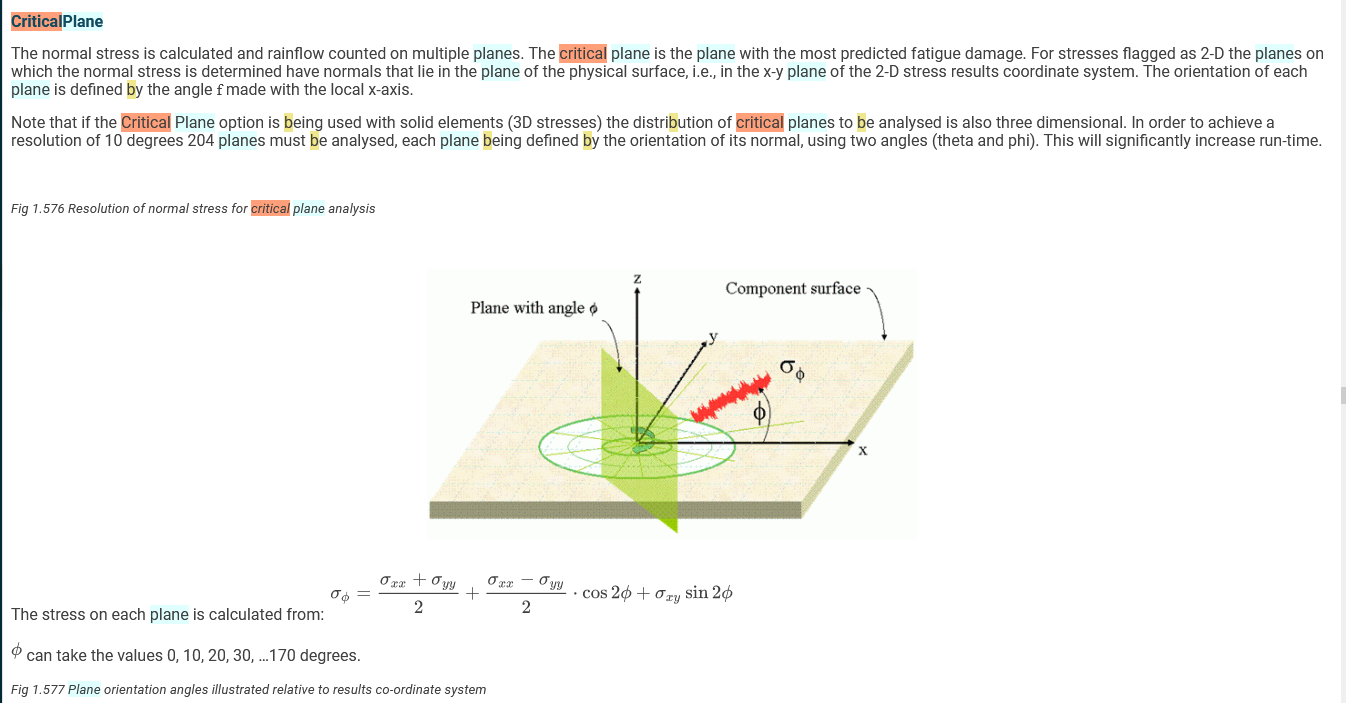

      I'd like to have some more information about the software itself. I want to estimate the fatigue life (strain based) with multiaxial stresses using a critical plane approach.
      Does Ansys itself has the approach implemented or only Ansys nCode? Which specific critical plane approach is implemented and can the approach be modified? A manual of the theory would be very helpful.
      Thank you for your help!

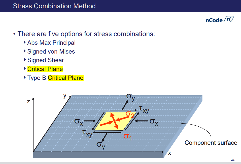

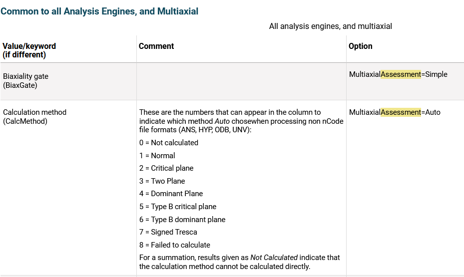

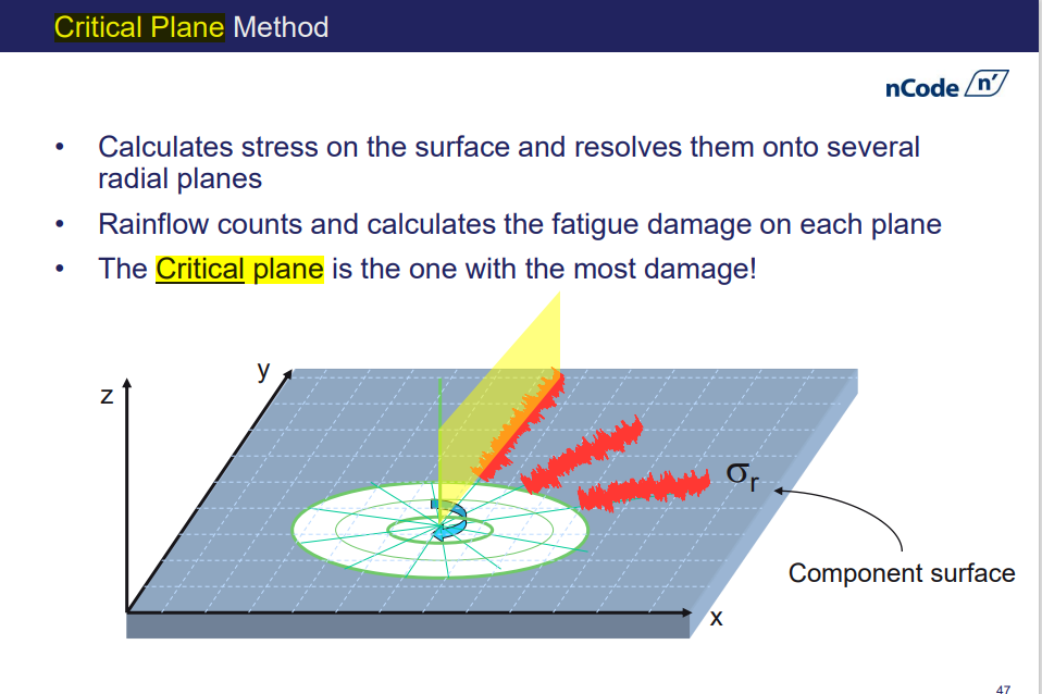

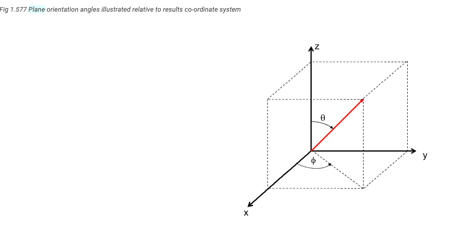

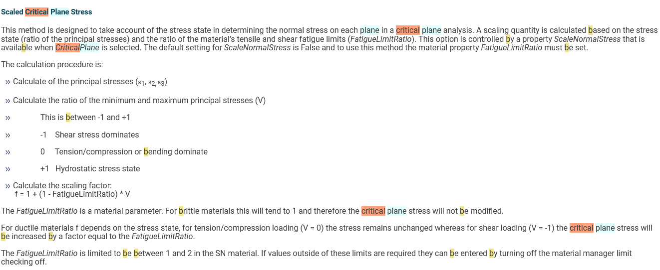

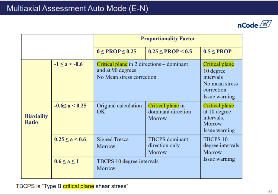

    • Dragana Jandric
      Critical plane approach for stress combinations is available in nCode. Here are some snapshots from nCode documenation. I hope this helps.
    • Flatter97xD
      thank you very much for your answer, this was really helpful.
