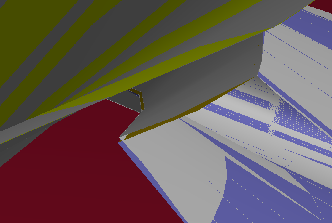

      I've applied fault detection and found 0 faults but after some exploring I found the following misalignment (image below). This is from a direct boolean operation in Design Modeller. This is carried over to fluent meshing and share topo in fluent meshing (join and intersect) also struggling with it. Is there any way to avoid this boolean error in Design Modeller?
    • Keyur Kanade
      Share topo should be successful in DM before proceeding to Fluent Meshing. Please work on your geometry. You may need to delete and recrete few faces/bodies.
