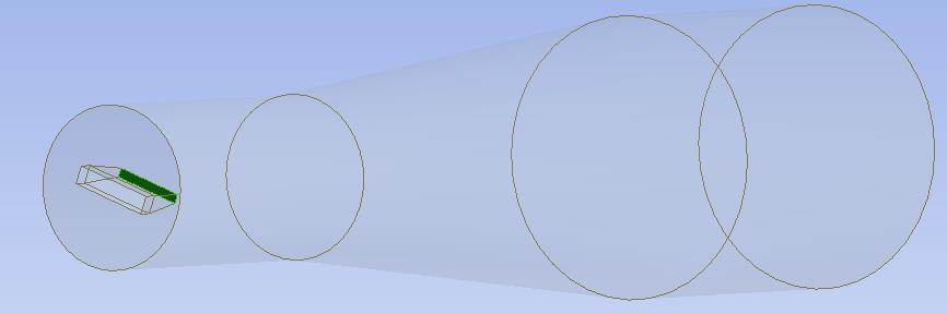

My geometry was created in DM. It's a single expansion ramp nozzle, ~1.5 Mach jet perfectly expanded. The fluid domain itself consists of the [internal] fluid nozzle body and an external flow field, pictured below. Currently, I have 3 bodies: the nozzle body; an inner external fluid body (the cylinder-cone-cylinder shape); and the outermost external fluid cylinder body. All bodies are "Formed as a Part."

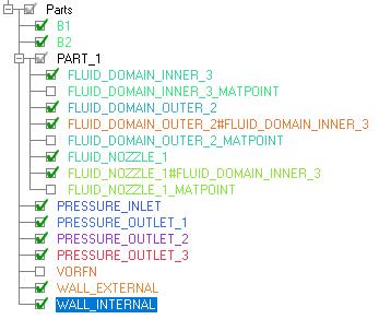

In DM, I created Named Selections for all of my boundaries: 3 pressure_outlets (faces on the external fluid bodies), 1 pressure_inlet at the nozzle inlet; and the inner and outer walls of the nozzle. These selections appear to pass through to ICEM as expected. However, several "parts" get added when viewing the Parts tree in ICEM. Referring to the below pic, the parts with the # character (e.g., fluid_nozzle_1#fluid_domain_inner_3) get created when I first open ICEM. What are these? I assume they're the shared faces between the bodies. How should I treat these in regards to boundary conditions? Should I not have the bodies formed as a Part in DM? How will this affect Fluent setup?
Furthermore, the parts B1 and B2 are parts I created in ICEM when I started blocking. The way I did it was by deselecting/hiding the external flow geometry so only the nozzle itself was visible. I then created initial block B1 by selecting all visible nozzle curves. Once finished blocking the nozzle, I hid B1 and all nozzle parts and enabled all external flow parts and created another initial block B2. When I create B2, I'm prompted whether or not I want to merge or replace the existing blocks: I select merge. I then make a handful of splits, o-grids, etc for the external domain.
How I should proceed after I'm done blocking and setting pre-mesh params is where I'm a little foggy. I did go through the Output Mesh tab and apply settings for boundary conditions...but I'm unsure of what to apply to every part listed in the above pic. Pressure_outlets, pressure_inlet, and walls are all self explanatory but I'm lost on what to do all components under PART_1. Should I leave their boxes checked/enabled? Or unchecked/disabled? Or do I even need to change settings for boundary conditions in the Output Mesh tab since I already created Named Selections?

1. ICEM-CFD works on surfaces and really doesn’t need any 3D bodies as such. Just the inlet, outlet and walls are sufficient for building a mesh in ICEM-CFD. So when you come from DM you don’t have to form a new part (you’d actually be better of not forming a new part for ICEM-CFD). What I usually do is, name all the surfaces (categorized as inlets, outlets, walls and sometimes interfaces). I group all the curves and points as separate parts. Then I delete the rest of the geometry which doesn’t have any other crucial information. Once the geometry is tidied up, I proceed with the blocking. And when I’m done with the blocking, I group and name the blocks appropriately so I can analyze them easily after the simulation is done.
2. You don’t really have to define the boundary conditions in ICEM-CFD. Just make sure you have just the appropriate geometry components (inlets, outlets, wall) and no dummy parts (like in your case). You can define the boundary conditions inside fluent.Â

1. What am I supposed to do with the face(s) at the true nozzle outlet which touches the external flow domain (both bodies pictured below)? I hadn't named them and didn't think I was supposed to. Those faces should share nodes (i.e., be conformal). The surfaces between the two external fluid domain should also be conformal. My question is then how do I keep these 3 bodies as separate fluid zones and have a mesh that is conformal between adjacent body surfaces/faces?Â

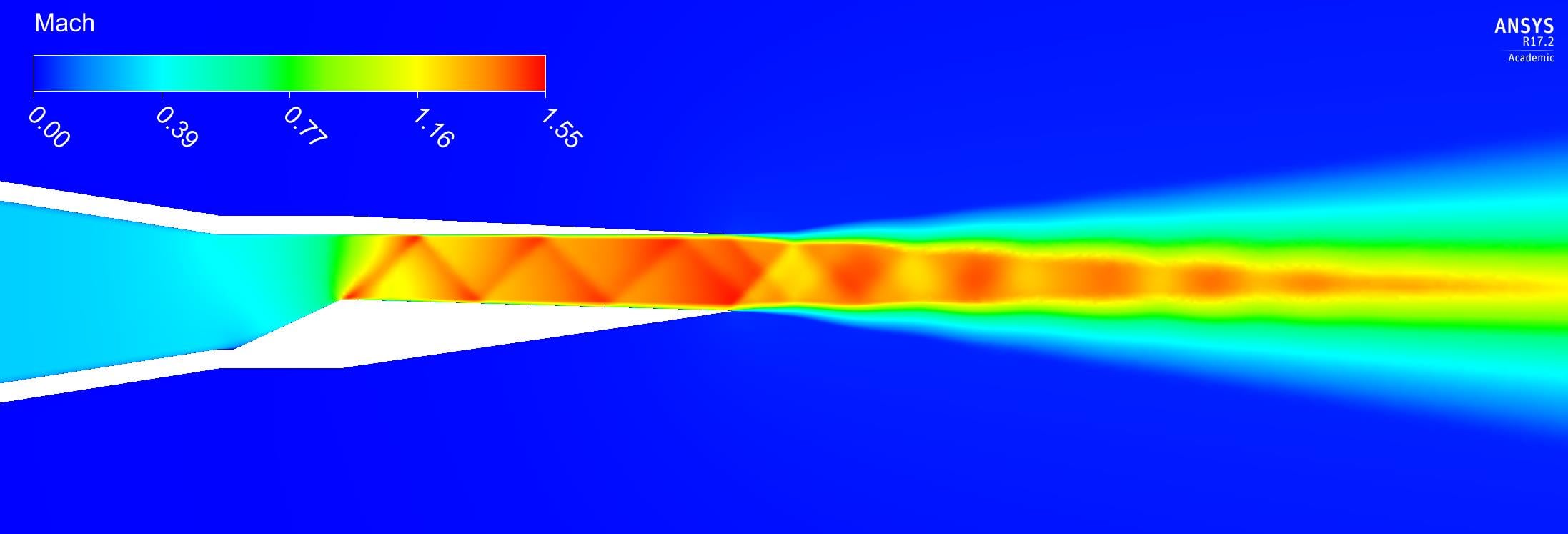

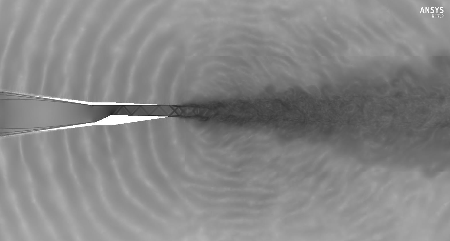

3) The nozzle I'm working with is for gas turbine engines. It's a rectangular converging-diverging nozzle. Similar nozzles are found on the F-22 Raptor, B-2 Spirit. Here's some contours from work I've done with the same nozzle but on an unstructured grid. The first is a steady RANS result: Mach number at a pressure ratio of 3.0 (pressure_inlet=2.0 atm gauge, all pressure_outlet's=0 atm gauge). The second is LES at the same pressure ratio however all outlets have non-reflecting conditions enabled. The reason I'm here asking questions is because the unstructured grid I used wasn't good enough for LES. As the solution progressed, convergence starts to creep upward. Not only that, but it eventually would take increasingly more iterations to converge per time step. I've already investigated other options...my issue was my grid. Hence why I went with ICEM CFD and a structured grid.

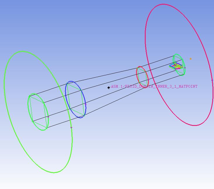

I have been trying to figure out my issue(s) and may have found a solution. I'm still curious if you have any recommendations. Anyways, I have found a method which allows me to keep separate fluid bodies yet have a conformal mesh (e.g., set pre-mesh params > edge params for an edge in one fluid body and have settings copied to all parallel edges in all bodies).Â
Step 1: With the geometry freshly loaded into ICEM, Repair Geometry > Build Topology. This merges overlapping curves/points (at least I believe so)
Step 2: Create an initial block for the inner conical shaped fluid domain, split at prescribed points, associate edges, snap vertices
Step 3: hide inner domain, create a second block for the outer domain, associate ending edges to large circles, split into o-grid and split at inner circles
Step 3.5: show all block domains. Note that there are overlapping blocks where the inner and outer domains intersect
Step 4: Begin merging vertices with update associations enabled at the inner domain circles by first selecting the inner domain vertex, and then the outer domain vertex. 3 vertices are shown merged below.
Step 5: Once all respective vertices are merged, hide inner domain and delete the inner rectangular blocks from outer domain
Below shows the completed blocking minus the nozzle. The above process is also followed for the shared edges of the nozzle and inner domain fluid bodies.Â
What this allows me to do is select 1 edge for Set Edge Params in any body, and when copied to all parallel edges, all parallel edges in ALL bodies are also selected. What I'm not sure of is how this will load into Fluent. Will Fluent detect interfaces? I have no idea. I just wanted to let you know what I've found out over the past couple days. I do appreciate your help and look forward to any advice you may have!
