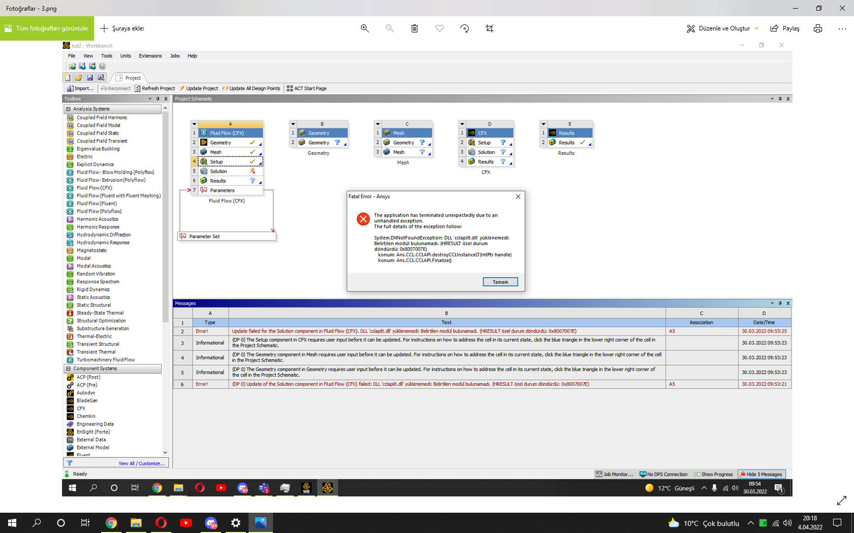

Ansys EmployeeHello,
What is the full error message you get? Which Ansys software are you using?
March 30, 2022 at 6:48 pmkadirkadir
SubscriberCant you see the pictures ? its already written there
April 1, 2022 at 12:47 amRebeca
SubscriberHello I'm having the same problem! I'm using 'Ansys Student 2021 R1' and the full error message was: "System.DllNotFoundException: N├úo ├® poss├¡vel carregar a DLL 'cclapilt.dll': N├úo foi poss├¡vel encontrar o m├│dulo especificado. (Exce├º├úo de HRESULT: 0x8007007E)". Meaning: It's not possible to load the DDL 'cclapilt.dll': It was not possible to find the specified module. (HRESULT: 0x8007007E exception).
So I can define the geometry, the mesh and the setup, but then I can't open the file on the CFX solver.
Thanks in advance for the help!

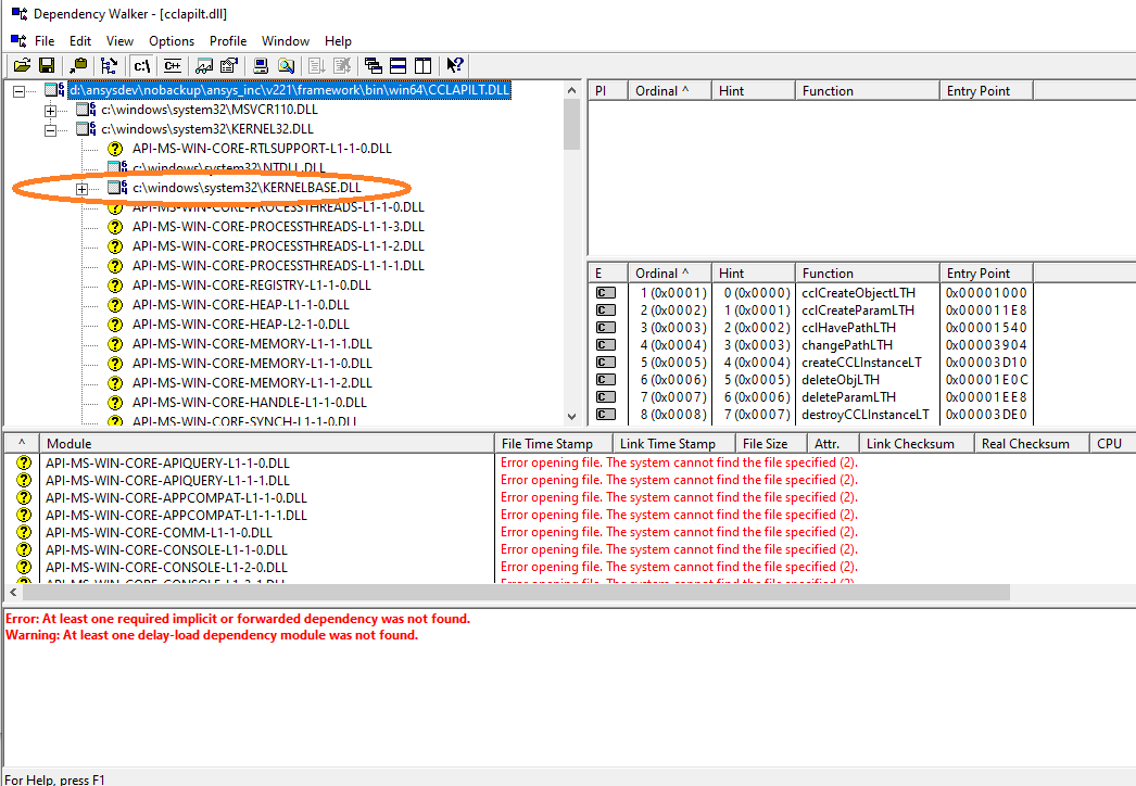

You can find out more about missing dependencies, using, for instance,a free dependency check tool called Dependency Walker (http://www.dependencywalker.com/). Simply download and run it, click File->Open and select the cclapilt.dll from ANSYS installation, the dependencies will be shown as in the screenshot below. If KERNELBASE.DLL is missing, it will be marked with a question mark. You can see that this file exists on my computer under C:\Windows\System32\.
