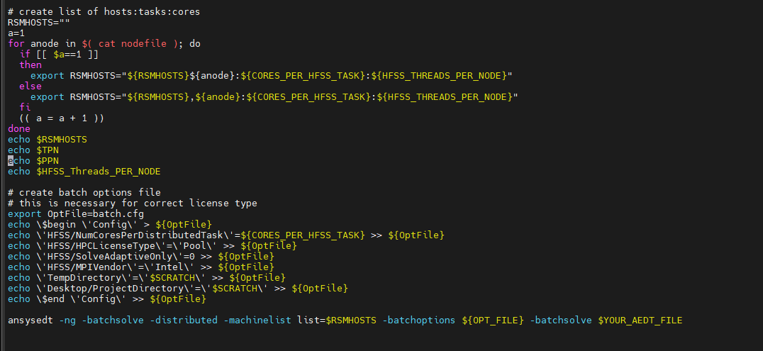

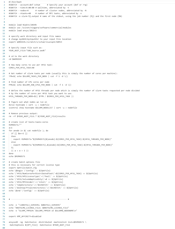

      Hi everyone,
      I am attempting to run Ansys HFSS on the Scinet supercomputer, which comprises 4 nodes, each equipped with 40 cores available for running Slurm jobs. My goal is to simulate a large domain, leveraging HFSS's domain decomposition feature, which allows simultaneous solving of different domains on separate nodes. I intend to split the simulation into 4 tasks and distribute them across the nodes. While I am familiar with distributing tasks on a single node, I am unsure about the process for distributing tasks across multiple nodes.
      Below is the code I am currently using. To submit the Slurm job, I use the command "sbatch sample.sh". Could someone kindly assist me with this? I am uncertain where I might have made a mistake.

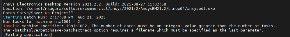

      It gives me error:
