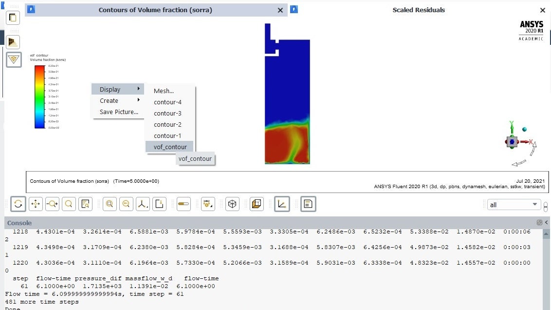

I want to save one contour picture (jpg) every N time steps in a transient simulation carried out with Fluent.
I set up the Execute Commands:
command-1 => /display/set-window 1
command-2 => /display/hc "name._%t.jpg"
And it correctly saves the image that appears in window 1. But the problem is that the image in window 1 doesn't update when changing the time step. It is always showing the same initial condition. How can I set the display so as to update the information along with the simulation?
Thanks,

I think the problem may come from another point as in the GUI of window 1, I do not see any change as time evolves. I have to stop the simulation, place the cursor in window 1, right-click and select vof in order to see a graph with updated information.
In the image below, I have ended the simulation at time 6.1 s but window 1 is still showing the contours at time 5.0 s (which was the time I re-started the simulation). I have to do "Display => vof_contour" to see the contours at 6.1 s. And if I re-start the simulation at that point, window 1 is always showing the results at 6.1 s though it internally modifies the results, as I know from saved data at different intervals. How can I synchronize the contourns of the image of window 1 with the results of the running time?

SubscriberI have removed all the execute commands and the problem persists. The display in the GUI does not update as time progresses. I have created a new display from Results => Contours and the information (contours) does not change with time. It permanently shows the initial value. I have to stop the simulation, with the mouse, go on the display window, right-click and select display again. Then, it updates the information to the new data. However, in other Fluent transient problems I do have display windows updating the information while the process is running. Maybe, is there an option to modify the update rate for the things displayed in the GUI? By default, should the display be updated every time step?
