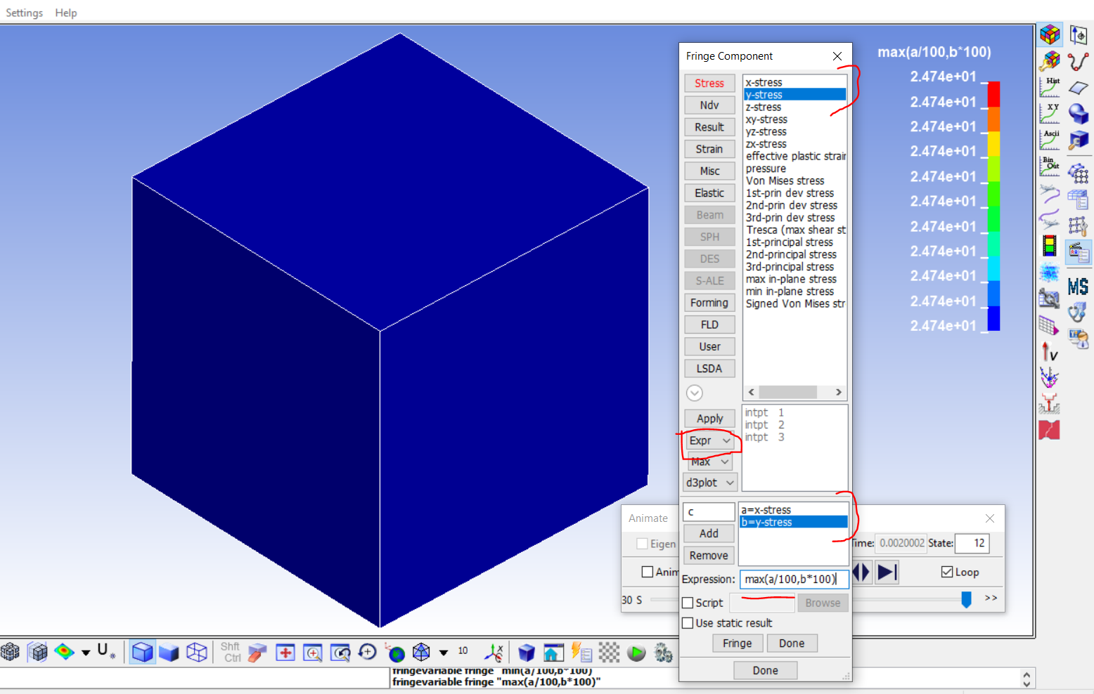

I want to evaluate an additional value as follow and show in LS-PrePost as animation.
F = max {sigma_1/S_1, sigma_3/S_3}
where sigma_1 and sigma_3 are the first and third principal stress and S_1 and S_3 are constant values.
Is it possible? I wish I don’t use user subroutines.

SubscriberThank you very match. The answer matches what I wanted to do.
