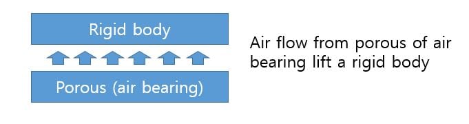

I am making the simulation to solve the problem as illustrated in the picture to study about the oscillation of the rigid body before it get equilibrium condition
I am wondering which module in Ansys should use to solve it.
It would be grateful if you give me a recommendation

SubscriberI recommend you edit the post and change the category to Fluid Dynamics. You will want to use either Fluent or CFX to model this.

SubscriberI simplified this model by simulation a rigid body is free-falling by gravity and under bottom face is subjected to a air pressure. I have tried but not successful in fluent
I think it should be use some kind of system coupling. Is it right?
