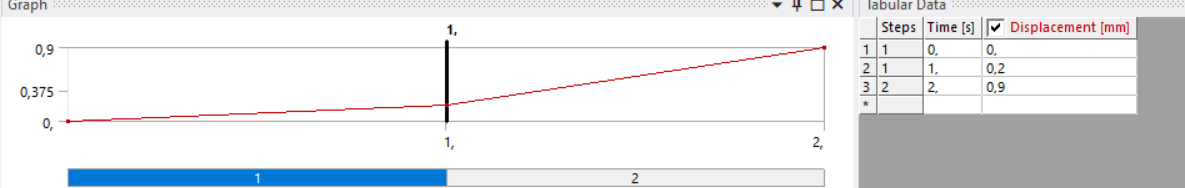

If I have a displacement to apply in two steps for example:Â Â
First step 0.2mm ;
Second step : 0.9mm ;Â
May 2, 2021 at 6:32 pmpeteroznewman
SubscriberDisplacements are absolute, not incremental. A step 2 displacement of 0.9 mm puts the node at 0.9 mm independent of what was used in step 1.
If you want ANSYS to apply 0.9 mm more in step 2 than the value used in step 1 then just add 0.9 to the value of step 1 and use that for step 2. In your example, that would be 1.1 mm.
