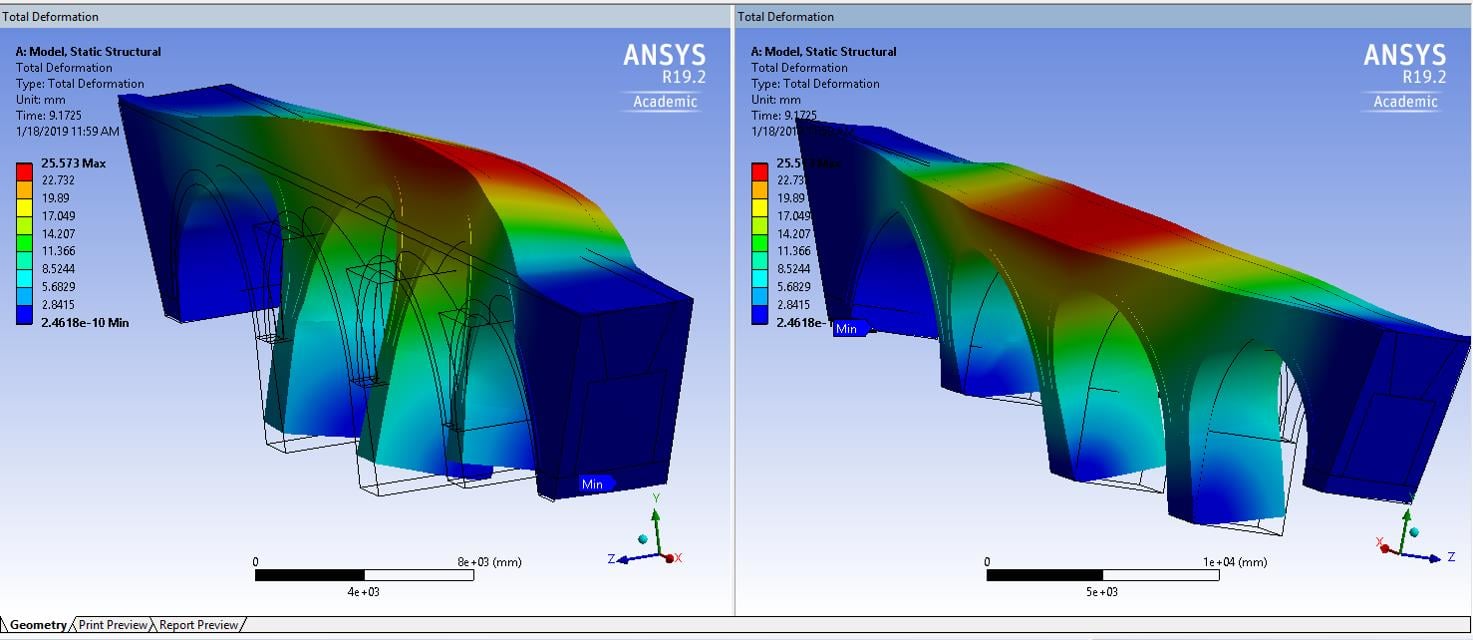

      I am studying the nonlinear seismic behavior of a masonry arch bridge by means of a static pushover analysis.
      I used macromodelling approach in which the masonry is modeled as a homogenous continuum material. Different structural parts of the bridge (spandrels, backings, arches, piers, fill) are modeled seperately and connected together with bonded contacts. Frictional contacts are assigned between the fill and the spandrel walls. I used SOLID65 element to model the masonry and bilinear isotropic model for the fill. As for the BC's, I have compression only supports with very high contact stiffness and zero displacements in horizontal directions so as to prevent early cracking in the piers.

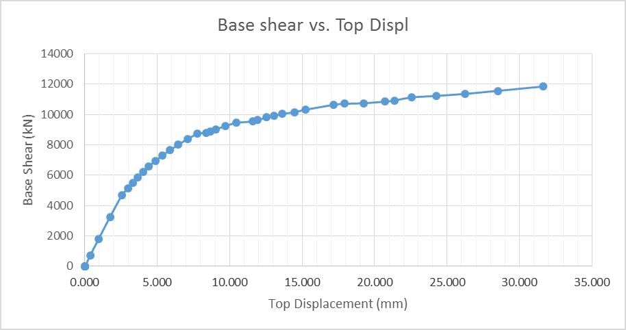

      Currently, I apply the force in the transverse direction of the bridge using inertial acceleration increased gradually (so, it's a mass proportional pushover analysis) and obtain the base reaction in the transverse direction & top displacement values until the non-convergence occur (see an example below). I am fine with the crack pattern etc. However, I can't obtain the degradation in the pushover curve with this method. Instead of increasing the force (inertial acceleration in this case) I need to apply displacement in the transverse direction of the bridge (although I have my doubts whether I can get the degradation with solid65 elements).
      Pushover Curve

      The behavior of the bridge is not straightforward to define i.e., mid part deforms more compared to the sides and the top part of the bridge somewhat rotates slightly as you can see in the figure below.
      total deformation at the last converged step
      I am using ANSYS 19.2.
      Any help on how to apply such displacement or improve the model is appreciated.

      When you say "the degradation in the pushover curve" do you mean you want to see the negative slope on the curve you plotted, past the convergence limit of the current acceleration-based input?
    • Semih
      Yes, exactly.

      On rotational behavior - it looks compression only support will allow for rotation - the bottom of three pillars can have zero displacement to avoid this rotation.
      Ashish Khemka

      Hi Semih,
      Under Analysis Settings, you can try to use Stabilization. That adds a fictitious force to keep the structure in equilibrium while continuing past the peak of a force-displacement curve.
      Regards, Peter

      Hi again Peter,
      Stabilization helps the analysis converge a bit further, thanks!
      Do you know how I can turn on the arc-length control? Do I need a command snippet for that?
      Also, I just can't picture in my mind how to past the peak of the force-displ curve and obtain the part with negative slope using this continuously increasing acceleration-based input. I would really appreciate if you have any explanation for that.

      I had started modeling a wall too, but didn't continue since I don't have the experimental data yet. It is a bit tricky with Solid65 elements and I am not sure if it works well with "small" structures like masonry wall panels, because cracks propagate fast and cause premature failure. In terms of the bridge model, the bridge's thickness is 4.3m.
      I recommend you to turn off crushing and use a shear transfer coefficient greater than 0.2 in Solid65, do mesh refinement where necessary (as Solid65 is a smeared crack model and is mesh sensitive) and use displacement-based loading with very small increments. Turn Modified NR and stabilization ON, and check strain energy vs. stabilization energy to be sure that stabilization is not spoiling your results.
