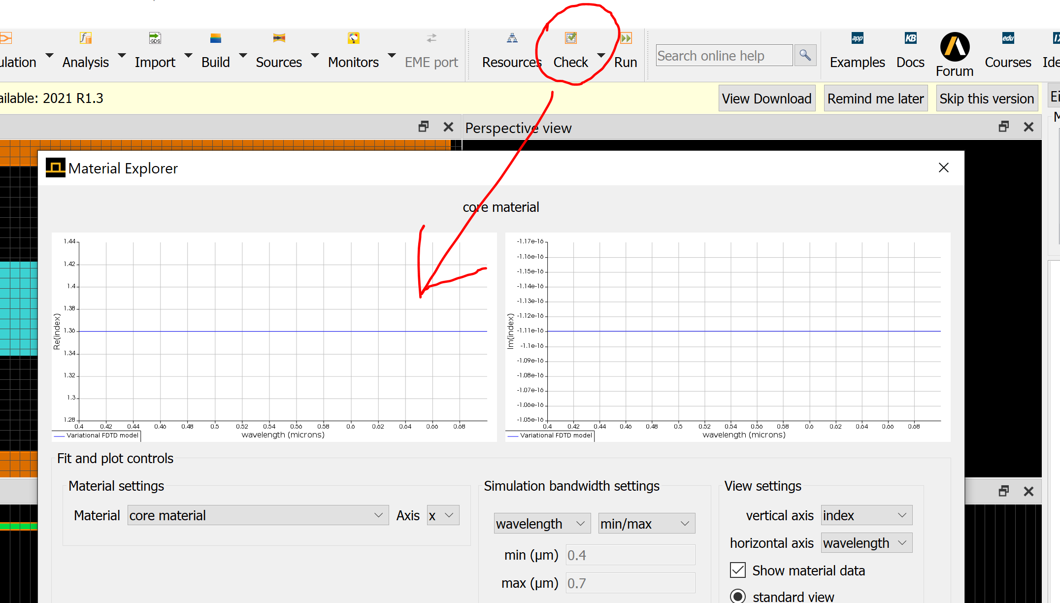

To check the effective index in varFDTD, right click "check" or choose from the down triangle:

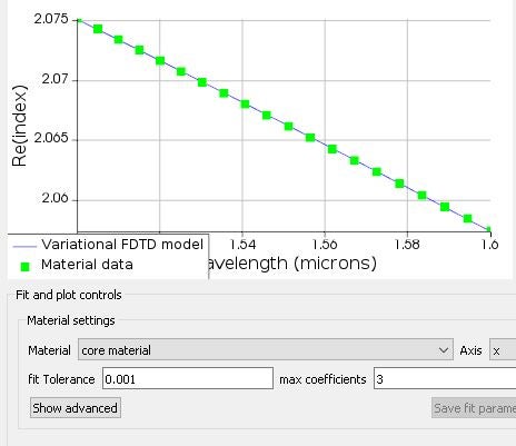

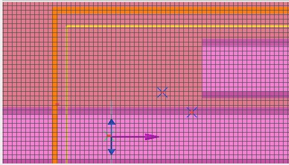

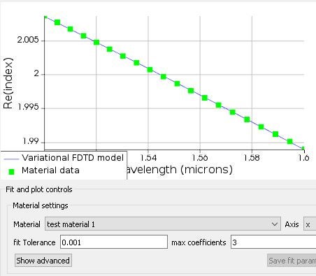

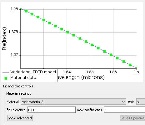

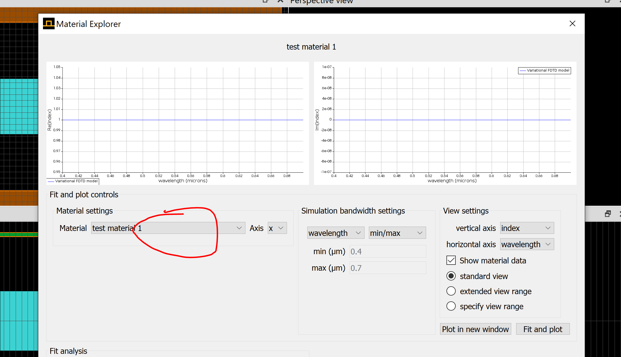

Subscriber.Thank you so much for your reply and sorry for the late response. I put the slab mode approximation green cross at almost the center of one of the waveguides, and one of the test points at the waveguide structure with the slant side and another one at the position without waveguide. The results seem to make sense except the effective index of the test point 2 is way off, since with the unetched 0.27um-thick lithium niobate, the effective index there should be approximately 1.8(the value calculated by the slab mode approximation) instead of 1.4. The results are attached in the pictures, do you have any other suggestions to make it right? Thank you!

Ansys EmployeeUnfortunately this might be what it is. Since this method uses the core mode profile as the reference, there is no guarantee that other places have the "correct" effective index using the reference mode profile. Please refer the principle page. If you think you can estimate the effective index by your own, you can do a 2D FDTD simulation using some data from VarFDTD, and import them into the FDTD material database.
