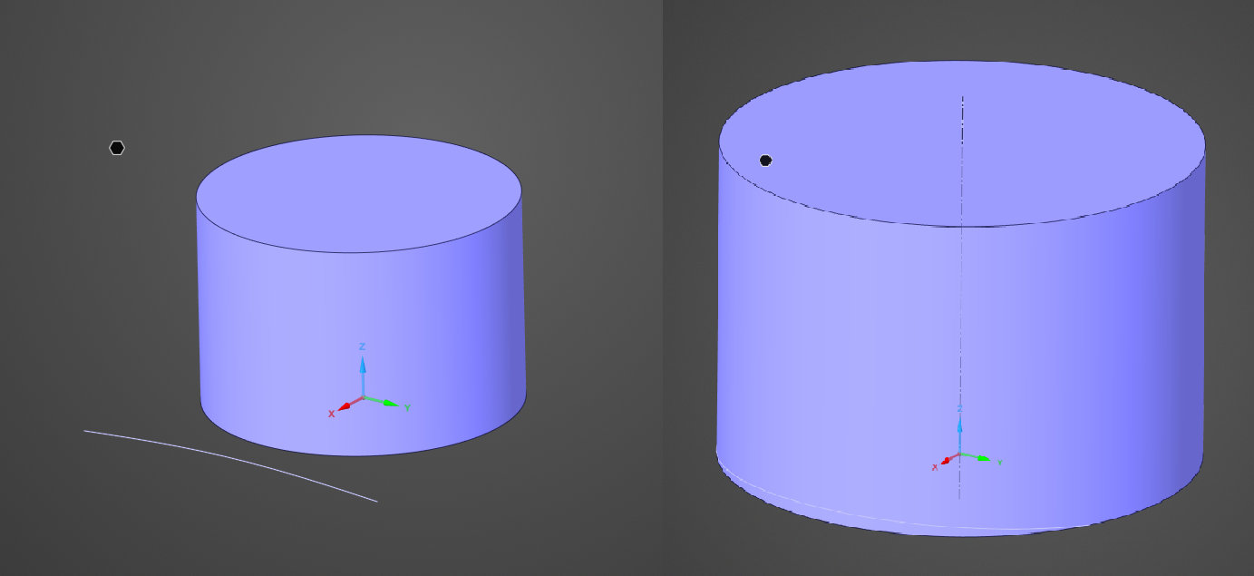

      Hi Guys,
      I have a Problem with PyAnsys scripting, I need a command or codeline for the Wrap-Tool in Ansys. For every Command in "Construction" i could simply use the Record Function of Discovery but for the Wrap-Command which is in "Prepare" this does not work.
      I've also read about a Wrap-Command that works with the Project-Tool (which would be nice because this works via the "Construction" Tab) but i cannot find the "Wrap" option there.
      I just want to Wrap a 2D-Curve around a cylindrical Object via Scripting.
      I Really Hope someone can help me !
      Thanks !
    • Naresh Patre
      Hello @Lukas
      I have the below commands from SpaceClaim scripting. I hope they will work in Discovery as well:
      option = WrapOptions()
      option.Extrude = True
      option.Imprint = False
      object = Selection.Create(GetRootPart().Bodies[0].Faces[4])
      target = Selection.Create(GetRootPart().Bodies[1])
      Wrap.Create(target,object)
