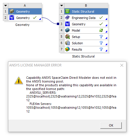

I am running Discovery and Workbench 2019R2. After creating a Geometry in Discovery Spaceclaim using a Discovery Essentials License, I export it to workbench. I am then unable to link that model to Mechanical. Â
Mechanical opens fine (I have a Mechanical Pro License) but the Geometry fails to attach with an error stating that I do not have a SCDM license in the pool.Â

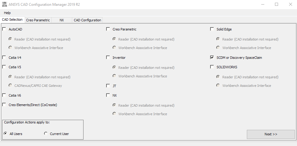

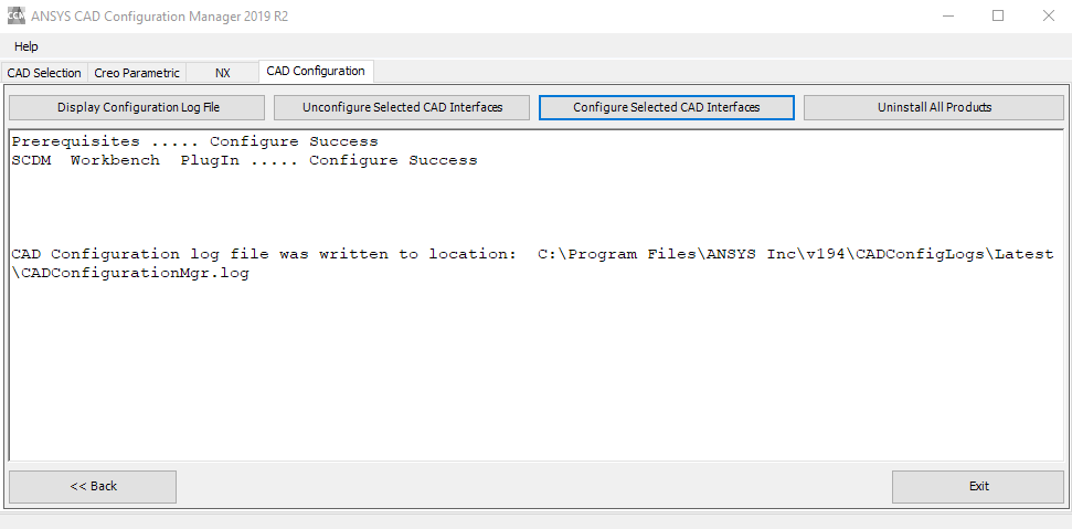

Is there an issue with the Discovery Plug-in? I have run the CAD configuration for SCDM and Discovery but this made no difference.Â
July 2, 2019 at 11:14 am
Naresh Patre
Ansys EmployeeHello Alex
Can you cross check whether you selected "SCDM or Discovery SpaceClaim" option within SpaceClaim and configured? Also, was the configuration successful?

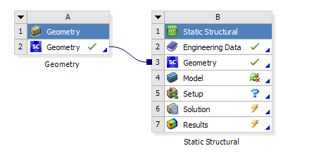

I am checking with the team and will let you know. Meanwhile, you can open a new Workbench session and import the Discovery SpaceClaim geometry and proceed further.Â

Naresh Patre
Good to know that you are able to import the file using External CAD option. I am investigating this issue and will let you know.

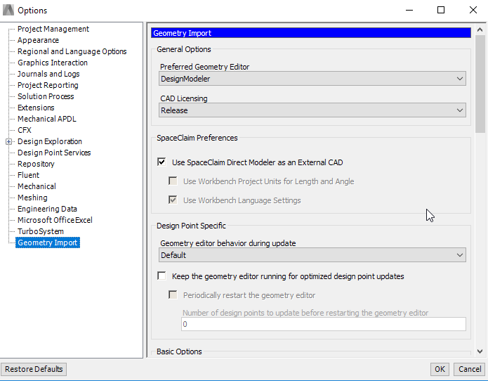

Naresh Patre
Ansys EmployeeHi Alex
Can you disable "Use SpaceClaim Direct Modeler as an External CAD", then repeat the process to reproduce the error and once done, send the client side diagnostics as per steps listed in below article? Send the Diagnostics zip file to ansys-discovery-support@ansys.com.

SubscriberHi Naresh ,
Sorry I have taken so long to get back to you, this problem seems to have been resolved with workbench 2019R2 no longer requiring a SCDM license to transfer imported CAD geometry from Discovery Spaceclaim to Mechanical. Even when SCDM isnt treated as an external CAD
Not sure what changed, but it has done the trick
