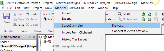

    • Naresh Patre
      Hello Russ
      I was able to import scdoc file (saved from Discovery SpaceClaim) into Maxwell 3D through Modeler - SpaceClaim link - Browse. See below snapshot showing this option. Can you try this out?
      I was also able to import a parasolid file exported from Discovery SpaceClaim into Maxwell 3D through Modeler - Import option.
