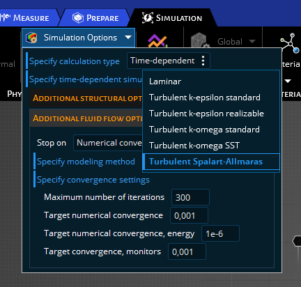

July 14, 2020 at 3:47 pm
papp
Subscriber-
July 15, 2020 at 7:14 am
Naresh Patre
Ansys EmployeeBálint PappÂ
The Turbulence model that you see under "Specify calculation type" are applicable only in Analyze mode and not in Explore mode. The Explore mode still uses LES turbulence model. In fact the turbulence model option for Analyze mode is not exposed in the UI. All the options under "Simulation Options are only applicable for Analyze mode.Â
