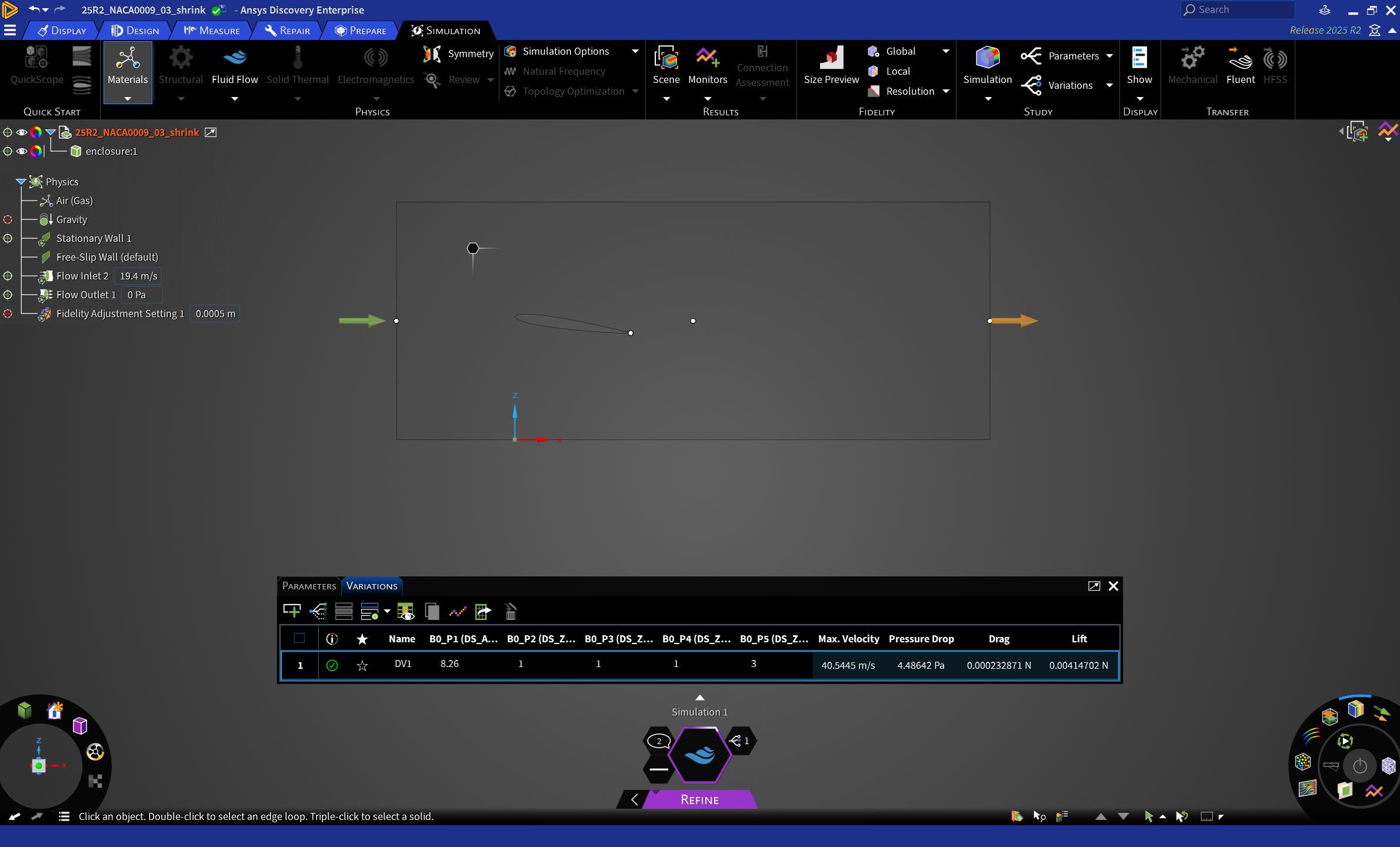

[Discovery Bug] f3d file’s CFD Refine result can’t be displayed
    • human890209
      The discovery project file and f3d file can be downloaded here:
      https://drive.google.com/file/d/1DTLxYPWJdp2St3isDKHgP0f-zltoP42U/view?usp=sharing
      I tested with the new Ansys Student 25R2 and it is not fixed.
