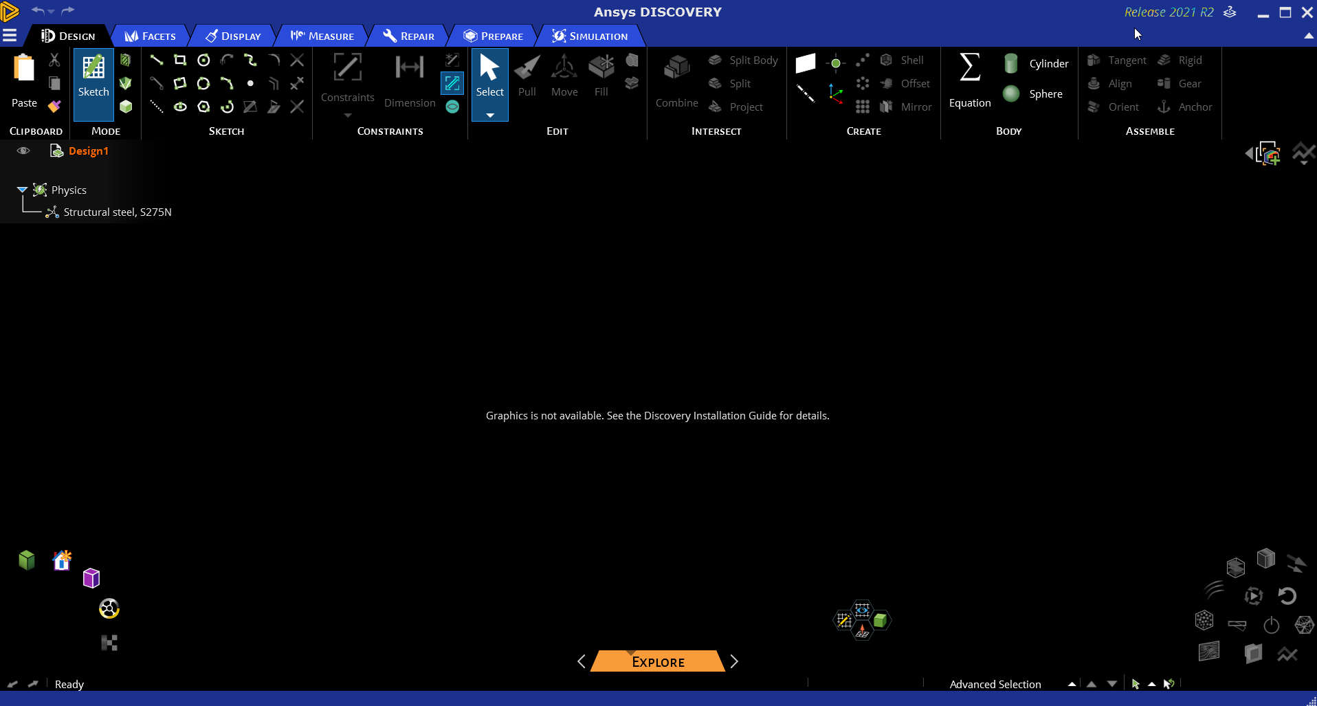

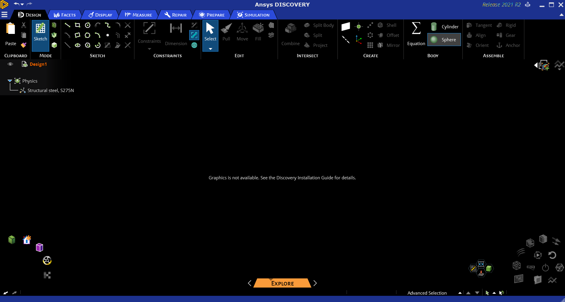

SubscriberI just installed ANSYS 2021, I am getting the following error when I run Discovery,
August 10, 2021 at 2:51 pmGeorge Karnos
Ansys EmployeeYou can try setting this variable on the Windows machine. QT_OPENGL=desktop
August 10, 2021 at 2:59 pmataraxia2021
SubscriberThanks for the response.
That did not work out
August 10, 2021 at 3:48 pmGeorge Karnos
Ansys EmployeeMake sure the Graphics driver for the Nvidia card is up to date.
Also, I would change it to use the Nvidia Card as the default Graphics processor for all
August 11, 2021 at 1:54 amAugust 11, 2021 at 2:09 amataraxia2021
SubscriberI just downloaded the drivers from the manufacturer's website, now Discovery R21 is working out.
The driver update from the device manager and windows update was not enough.
Thank you for your help!
