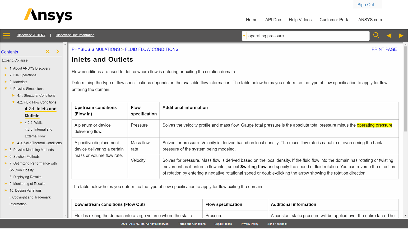

      Could you please confirm if the operating pressure in Ansys Discovery 2020 R2 is set to atmospheric pressure, 101325 Pa? I could not find this information in ansyshelp.ansys.com.
      When a boundary condition such as a pressure outlet is assigned with a pressure of 0 Pa, does this mean that the absolute total pressure would be 0 Pa +  101325 Pa?
      That is correct.
      At the outlet, you can use both absolute as well as gauge pressure, as long as it is static. The measurements will be shifted by 1bar based on the pressure measurement type you are using and provided you have consistent type throughout the fluid domain. If you are specifying inlet pressure as well, then it needs to be total pressure and not static (be it absolute or gauge, as long as it is consistent with the fluid domain).
      That is right. 0Pa will be the gauge pressure.

        Hello Charudatta Bandgar,
        Thank you for the quick response.
        If I understood correctly, Ansys Discovery will automatically adjust the operating pressure behind the scenes, based on whether we specify absolute or gauge pressure?
        For example, when using a velocity inlet (e.g. 1 m/s), then the pressure outlet can be either gauge pressure (e.g. 0 Pa) or absolute pressure (e.g. 101325 Pa), as long as it is static pressure?
        When specifying a pressure inlet, it can also be either gauge pressure or absolute pressure, just that it needs to be static + dynamic pressure? And if gauge pressure was specified at the inlet, then similarly, the outlet needs to be gauge pressure?

        Yes, that is correct. As long as the measurement method is consistent throughout the fluid domain, they are good.
